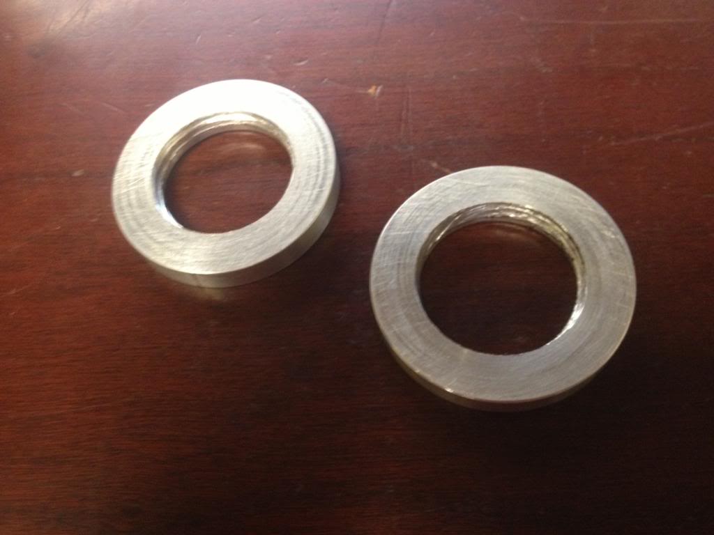

This update all started with Jason "P38Rhino" giving me an idea. He said somewhere on the inter-web he read about using a spacer to push the front radius arm forward. The goal was to help keep it off of the body work. A couple measurements later and a phone call to our spacer manufacture and we had these.

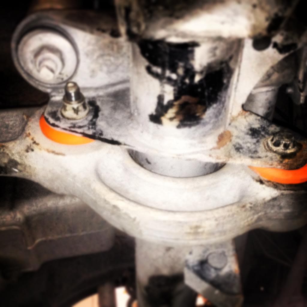

In order to put the spacers on we had to take the front radius arms out. If we were going to take the front radius arms out we might as well install set of Pollybushings.

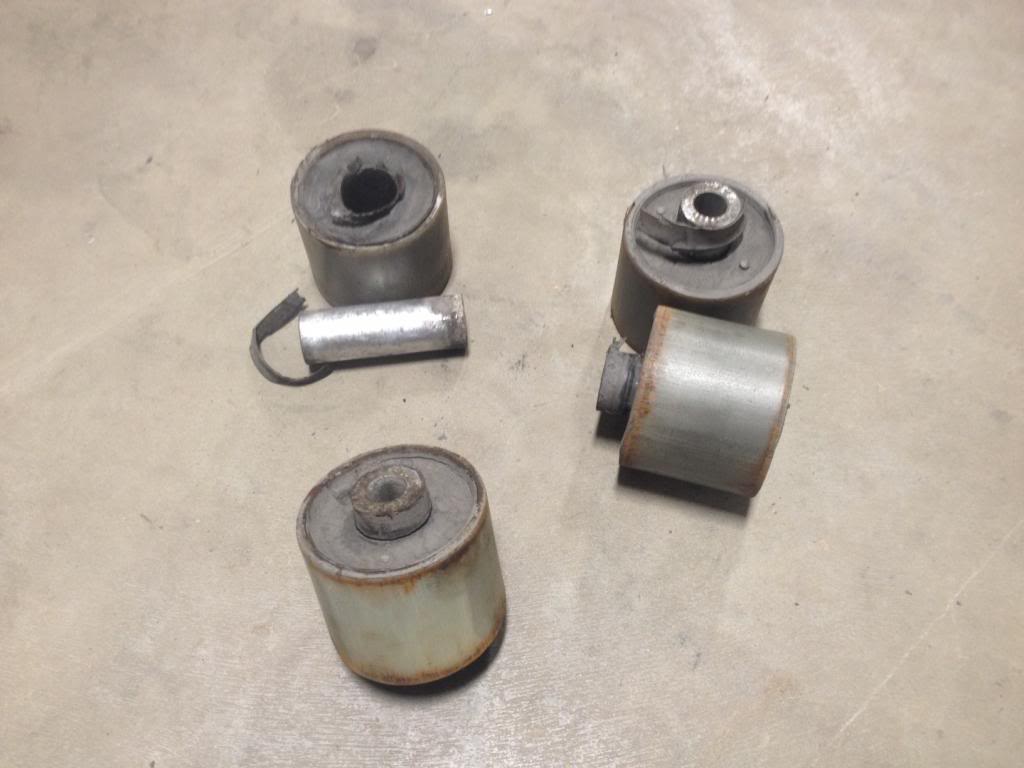

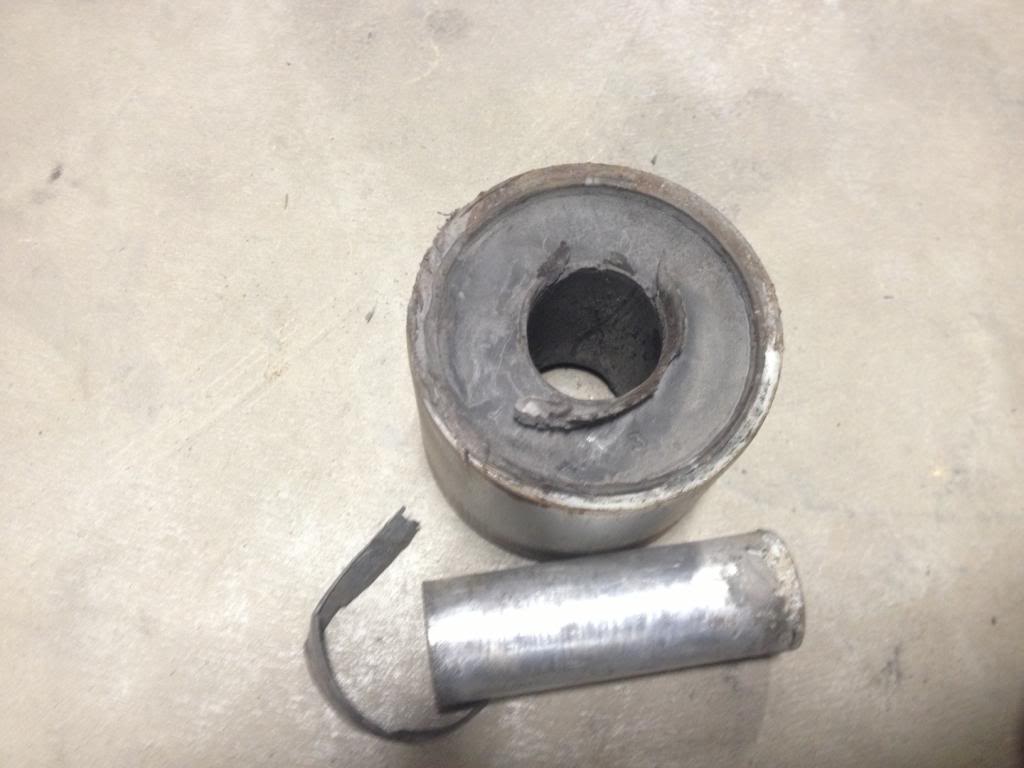

It was a good thing we went for the Pollybushings because the stock ones were reduced to complete garbage.

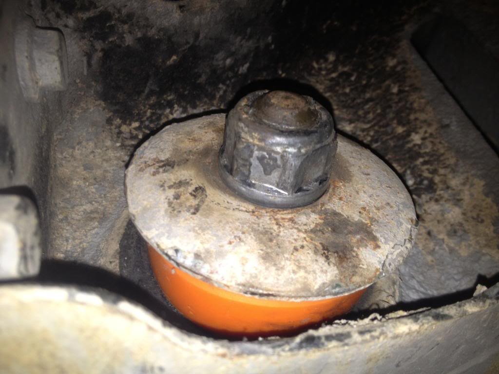

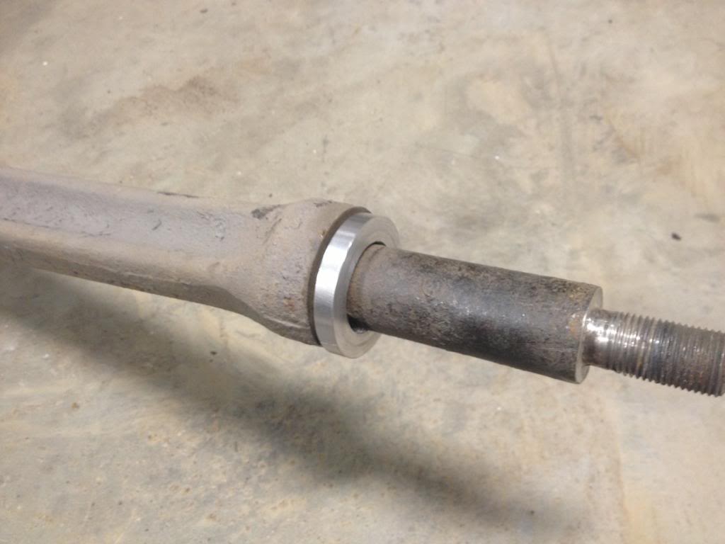

With the axle portion of the radius arm bushings taken care of it was time to try out our spacer.
The spacer fit perfectly. Leaving just a little bit of thread showing. This took advantage of all the extra space that Land Rover provided us.

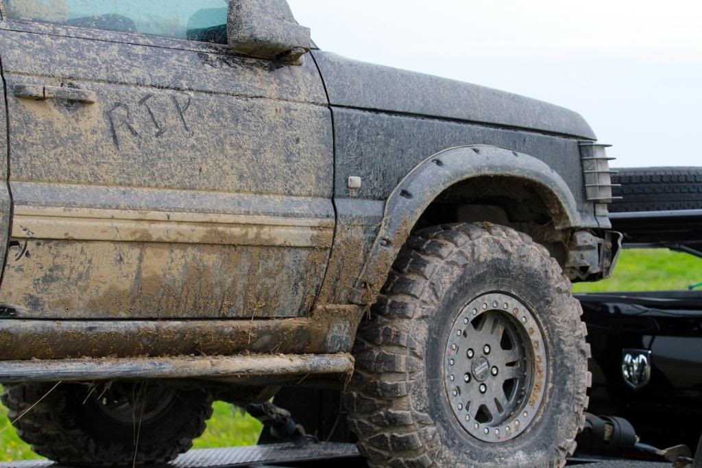

Last weekend the P38 went to one of the best family Land Rover events in America, the Wilds.

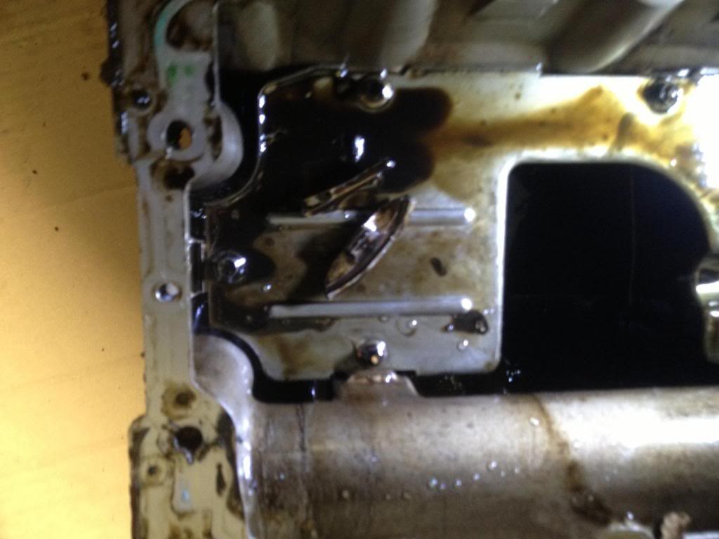

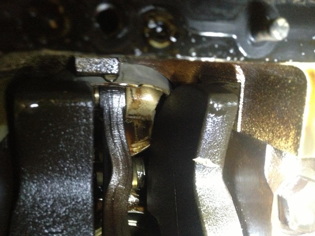

Once we had the truck back at the shop the first thing to do was drain the oil.
When the oil comes out that clean you know there's an issue. From what we can see underneath rods eight and seven are bent and the pistons have been destroyed.
