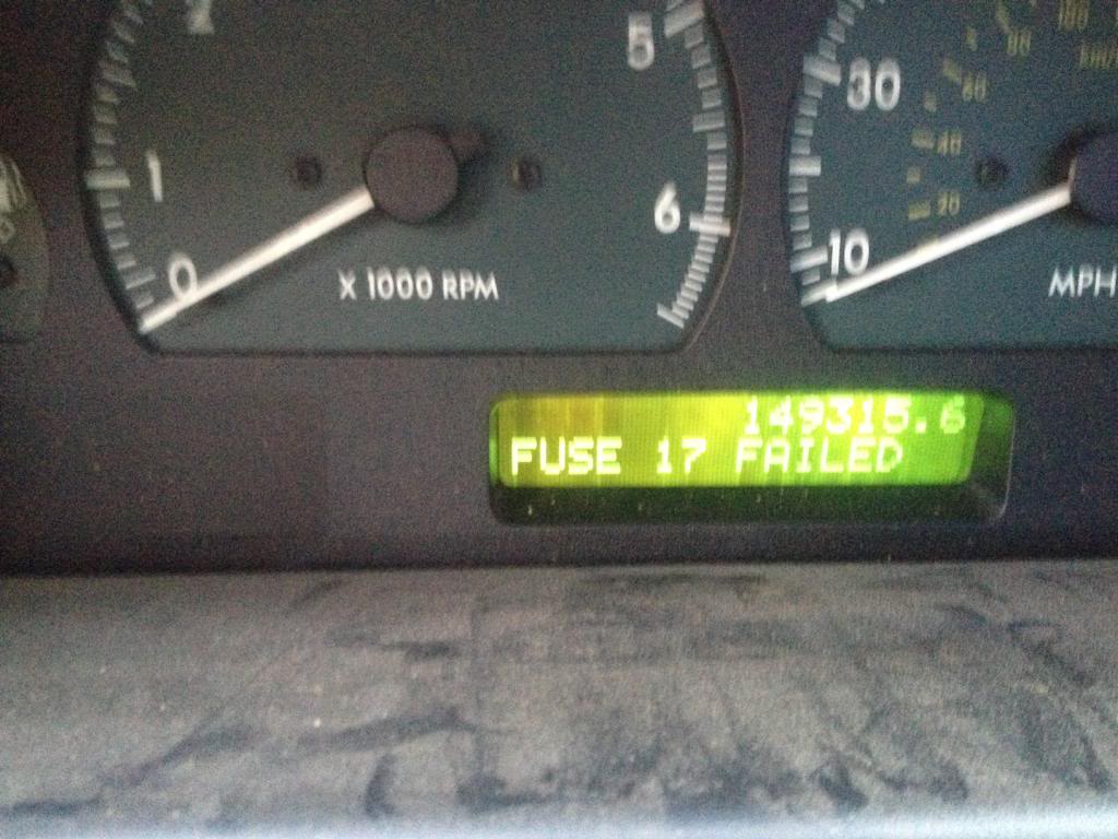

The new HD bumpers were not here in time so we were stuck with stock. Attached to the stock rear bumper was the trailer wiring harness. This will be relevant soon.

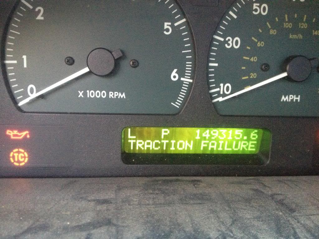

The trails of Rockcreek quickly eliminated the wiring harness. The remaining wiring shorted out and blew the brake light fuse. On most trucks this would not be a big deal but the P38 is not most trucks.
Unfortunately this fuse was also linked to the ABS
And without ABS you don't have any of this
The P38 was in a deep gully with rocks on either side. This made the doors impossible to open and prevented anybody from reaching the fuse that was so inconveniently located under the passenger seat. We decided to winch it out and when i jumped back in the truck to put it in drive it was stuck in park.
So quick recap of fuse number 17
Can't take the truck out of park
No ABS
No traction control
Oh yeah and no brake lights

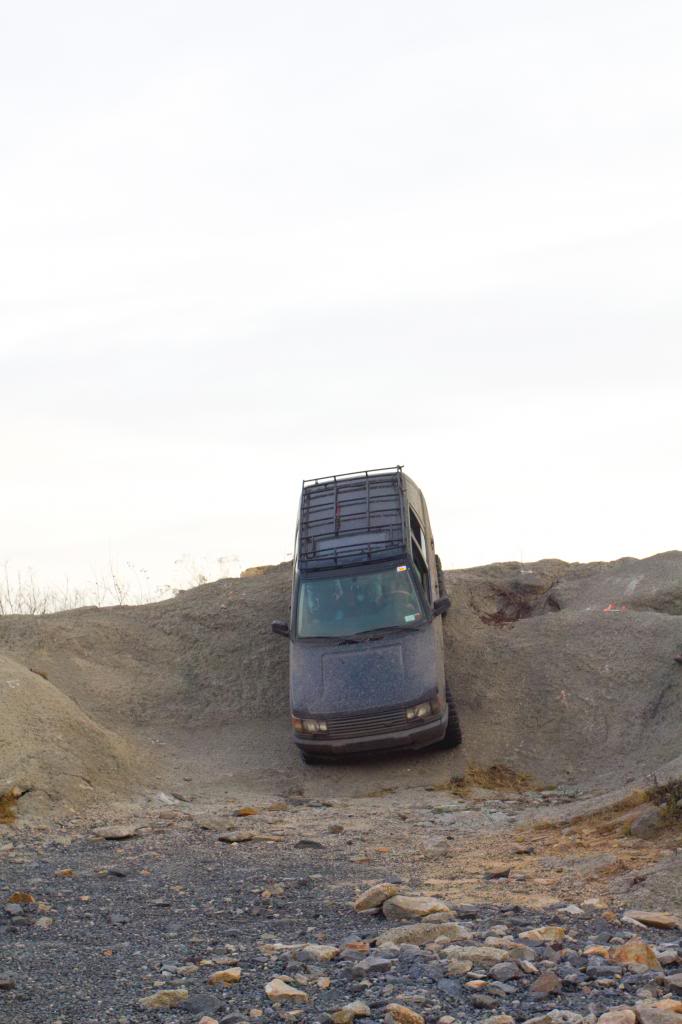

The pictures never look as steep as it really is

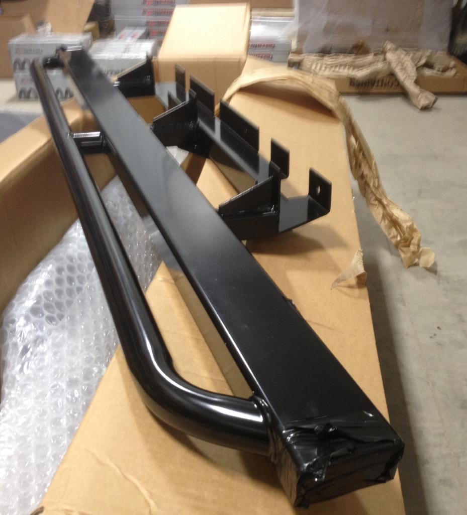

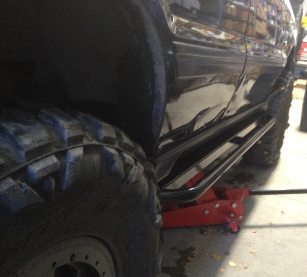

Here's a quick update with good news. We received the sliders and like a kid on Christmas I couldn't wait to rip open the box.
So far Im very happy with the build construction, powder coating and the way they mount directly to the frame. As you can see in this picture they fit the truck nicely.
We installed the passenger side and everything went quite well. We are saving the drivers side for the install video.
Things are moving forward with the locking Tcase too. Hopefully I'll have an update on that before the end of Jan.

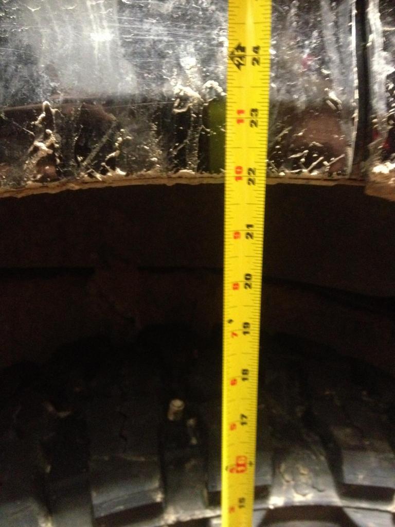

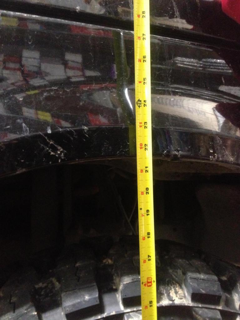

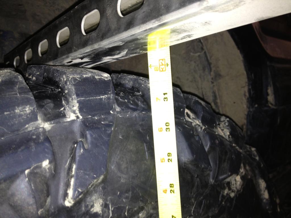

When talking to people about this project everybody has a different opinion on what size lift we have.
Hopefully we can clear this up. If anybody has access to a P38 with stock suspension could you take some measurements for us?
I would love to know the measurements in standard mode from the center of the wheel to the bottom of the fender front and rear please.
This is what we currently have on our project.
The front
21.5 inches
The rear
22 inches.
Just for reference the 305/70/16 tires on the truck
32 3/4 inches
Thank you for your help

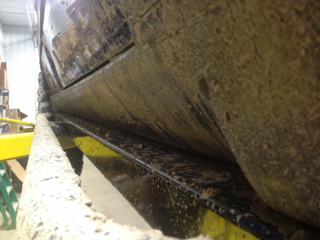

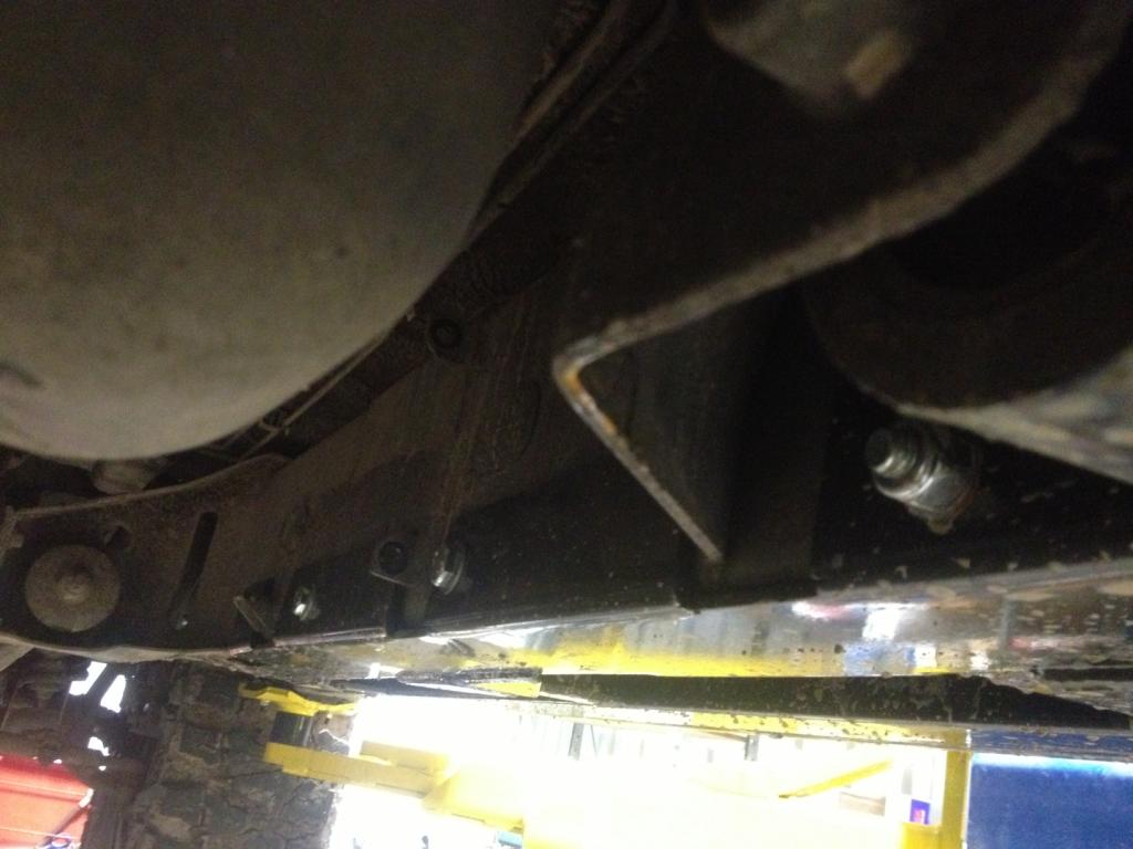

With the sliders installed we played around with them a bit. Heres a quick review.

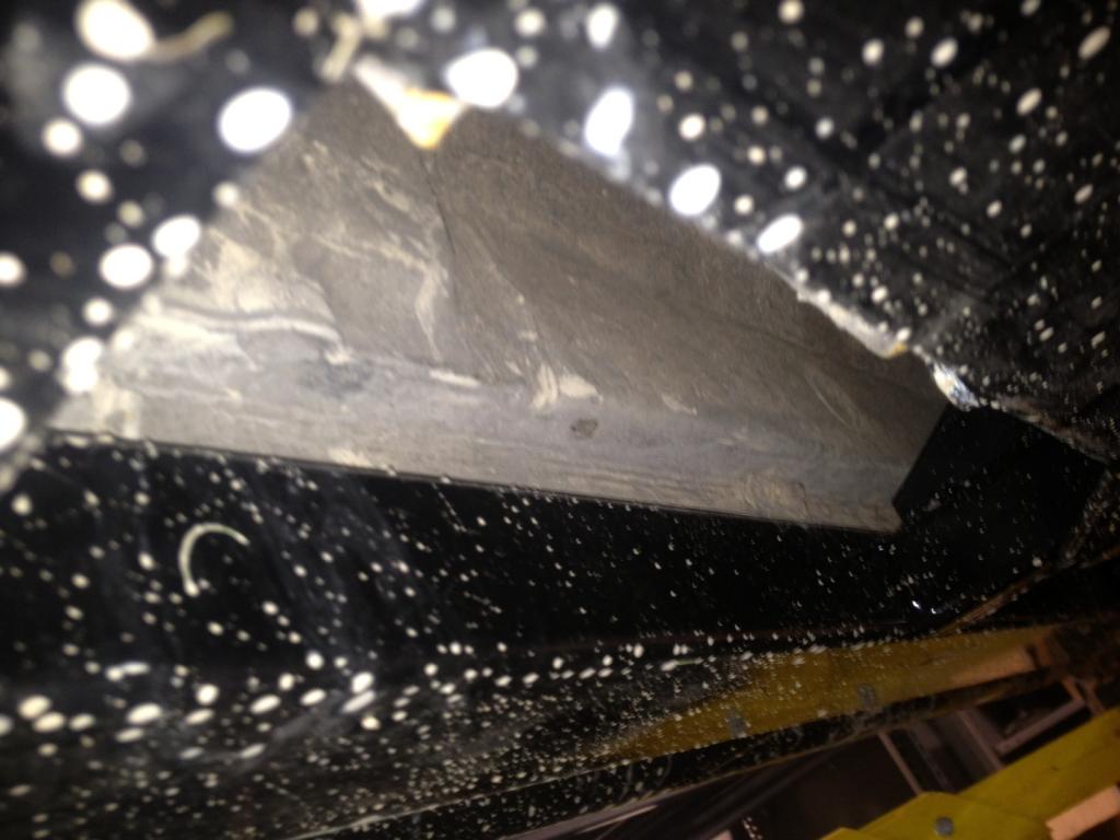

For the most part the install went quite well for these 3 bolts
But this one below was a little bit of a challenge. You needed to be spot on when drilling the hole.
As you can see in this picture the top of the slider fits snugly against the sill. You get to mount directly to the frame and still use the sill for support.
Over all We think they fit the truck nicely.

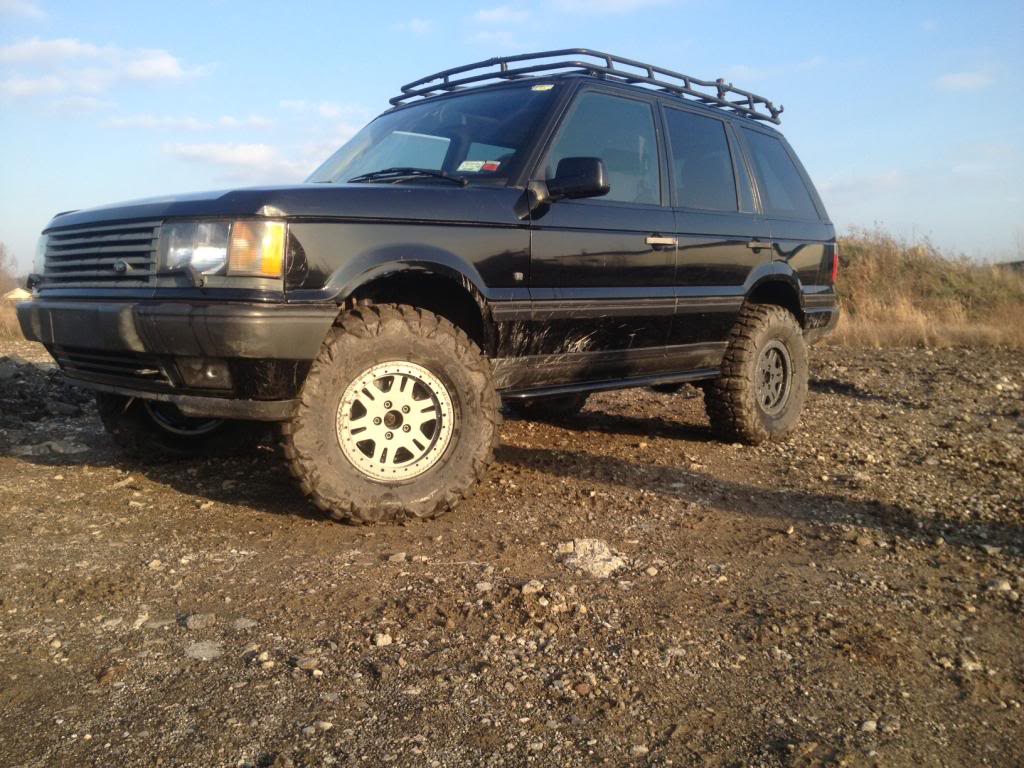

Playing on a gravel pile
coming down the pipe soon will be diff guards. As you can see from this picture we are on thin ice.
