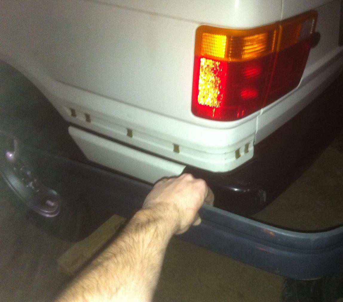

I am trying to pop the exterior trim in the back left corner back on but it seems as if I can only get the top or bottom in but not both at the same time. Does anyone have any tips for this?

Pull the plastic retainers out of the body panel first. Then insert them into the aluminum channel on the trim piece, line them back up with the body and push back in.
To get the plastic bits into the channel insert one side first then put a screw driver vertically on the other side of the channel then push down on the plastic retainer and finally use the screwdriver as a lever to guide it in. The plastic will bend then pop into the other channel so don't worry about breaking it.
