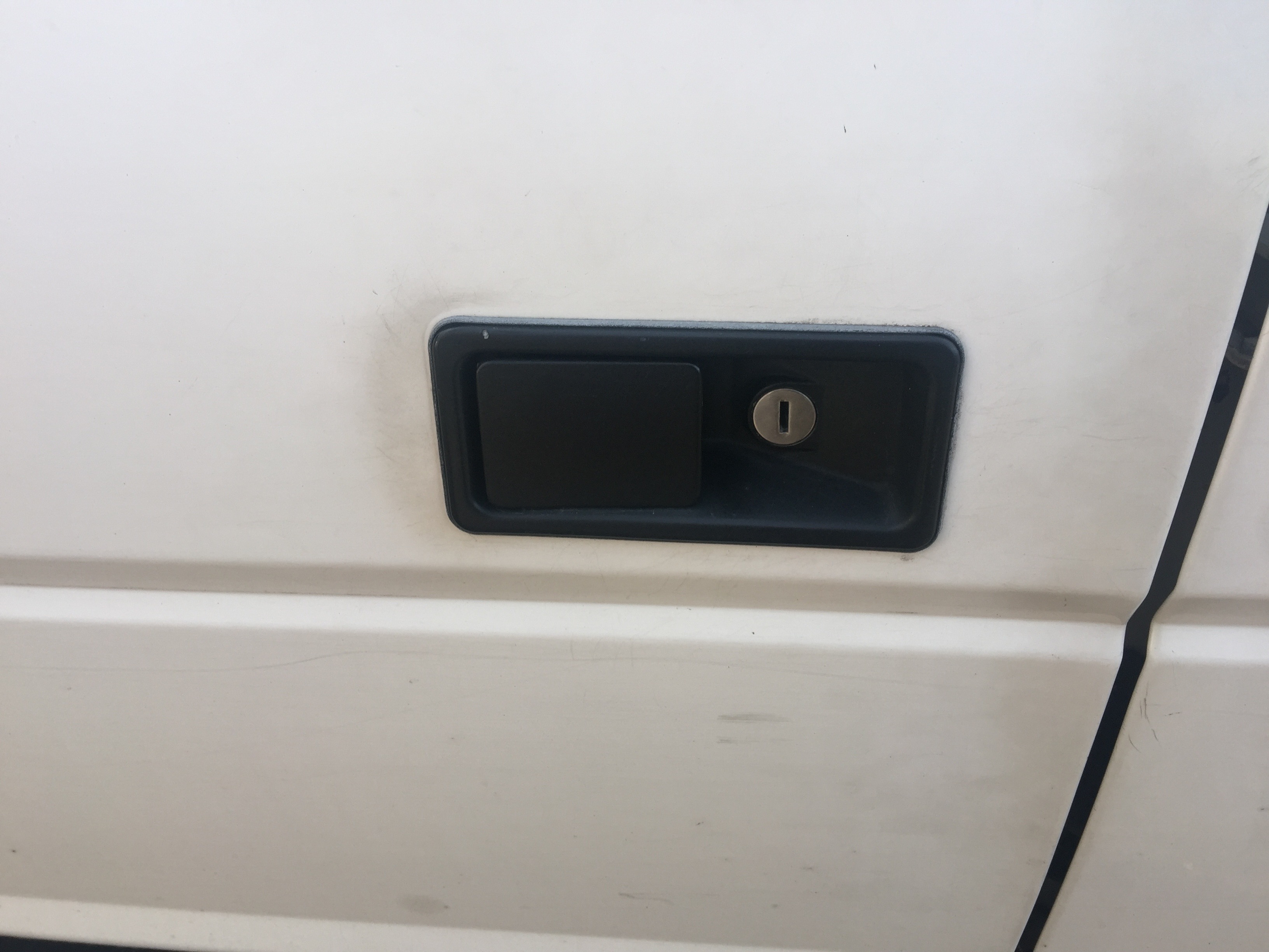

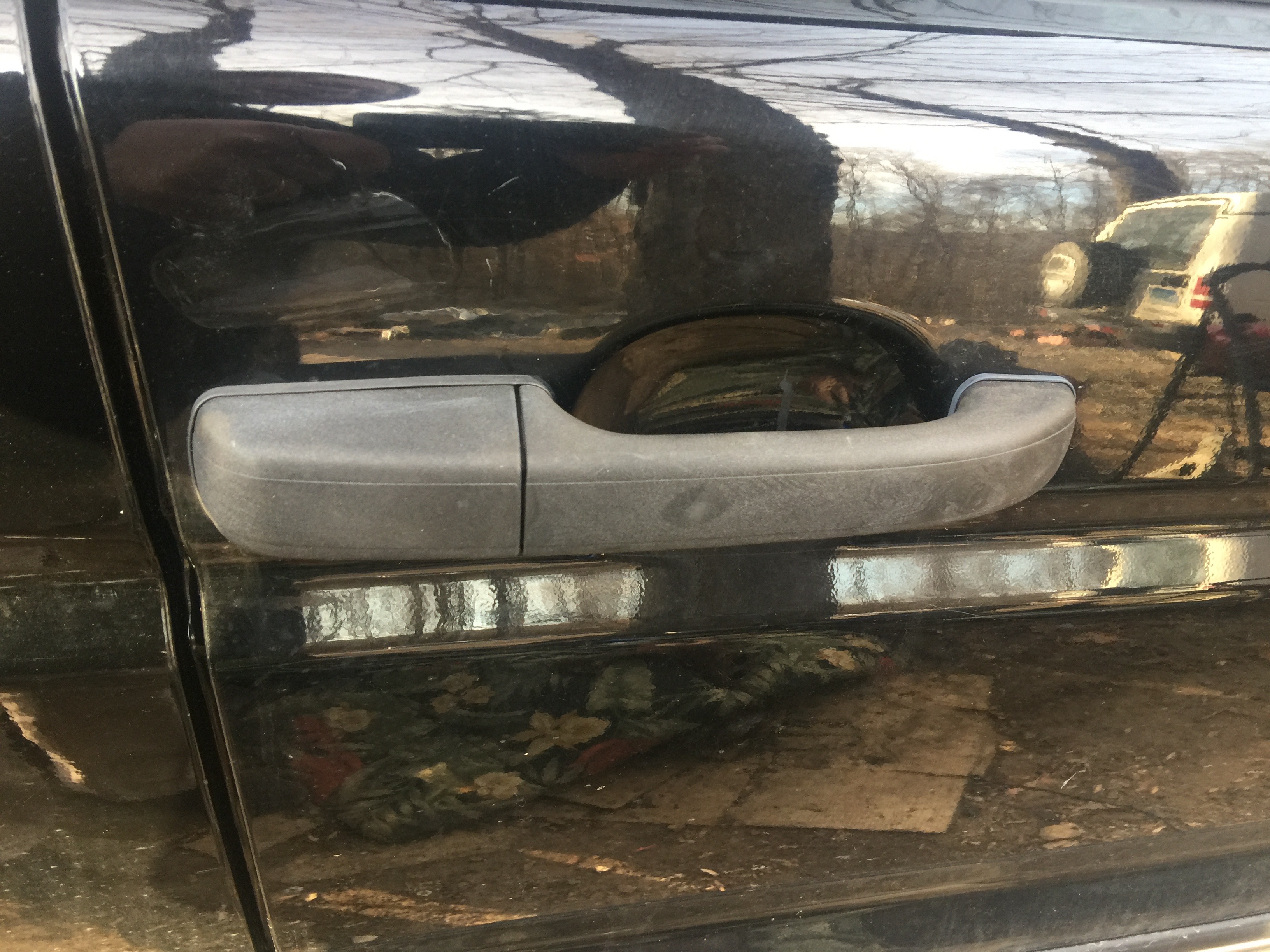

Tonyfnb, what do the door handles on your truck look like? Which of these photos looks like your truck?
Attached Thumbnails 1999 Disco Series I Wheel Hub Assembly-img_2812.jpg   1999 Disco Series I Wheel Hub Assembly-img_2813.jpg

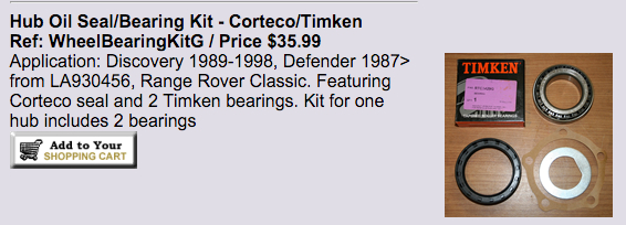

Based on his posts about needing a distributor, $200 ignition wires and now new hubs on a DI, I honestly think, more than anything else, he needs someone who knows something about these trucks to take a look at his. Timken T37 bearing and race sets used to be about $20 a piece. Two per hub and with a new seal and you're good to go. Now, I don't know if I'd want someone who's never held a tool before punching out a race in one of these hubs (at least without some guidance) but there is no reason anyone with a DI would need to purchase new hubs. Even if a stud was broken off you can still buy genuine replacements.

Here's all you need, from Trevor, at Rovah Farm. Each kit will fit a side.
Attached Thumbnails 1999 Disco Series I Wheel Hub Assembly-screen-shot-2016-03-01-7.50.48-am.png
