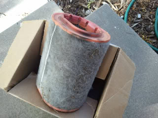

I had read the bulletin about the cat getting the small crack and asked him to check that. It was fine no crack. I pulled the air filter out today and it was absolutely disgusting. Put in a new one so I am hoping that helps. Showed my brother the air filter and his exact words were I am surprised the thing even starts with that air filter.

I believe once you remove the coil you get to the plug correct? Same deal on the Audi we have. If the plugs/coils and air filter don't do the trick I will take it to the LR dealer and have them inspect the Cat. Here is a picture of the absolutely filthy air filter I removed. I can already tell a difference when driving it.

If the air filter (which is pretty easy to get to) looks like this, wonder what other filters might be "overdue" ? Clean throttle body and MAF sensor (if so equipped)? Not that these will deal with existing codes, but couldn't hurt.

I haven't gotten into it that much yet. I plan on doing the fuel filter and all fluids next weekend. I will check the throttle body and MAF sensor as well.
