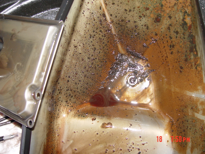

what do you think of this tranny pan? gritty junk in there -- I'm guessing clutch parts? Yikes.

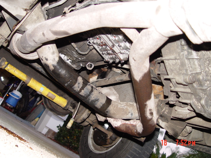

No - you don't have to completely remove the Y-pipe and crossmember.... front of Y-pipe, all bolts from crossmember and lower it 3/4 the way. makes a mess...
