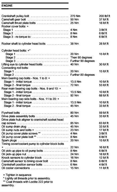

So today I removed the crankshaft pulley to get access to a bolt I needed to take out, all well and good but I'm not to sure of the correct torque when tightening.
Also is it just a case of putting it back in position and tightening to correct torque and job done or is there something specific I need to do?

Thanks for the info, I do have a torque wrench 👍 I was told that the 300tdi engine was just 80Nm.
How can it be so different??
Crankshaft Pulley Bolt Torque = 200 lbf.ft
And if you need an affordable torque wrench try > https://www.tekton.com/1-2-inch-driv...e-wrench-24340

Crankshaft Pulley Bolt Torque:
V8 = 200 ft/lbs
Tdi = 60 ft/lbs plus 90 degrees
