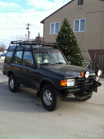

Hey guys, came across a good deal roof rack- rovers north rack for a D1 only problem is I have a D2 (2004) with dual sunroofs. Not sure if the D1 has sunroof. Will it fit my vehicle ?????

If its a hi rack it will fit just be a little short, if its the low rack it will still fit just can't open suroofs, pic looks like hi rack but I can't really tell
