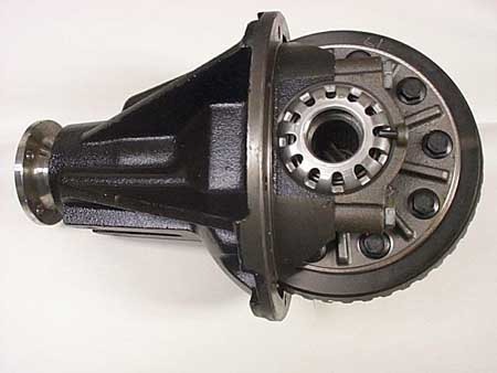

Did you replace the whole third?

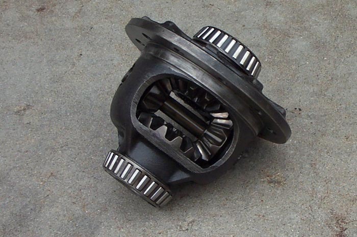

Or did you replace this?

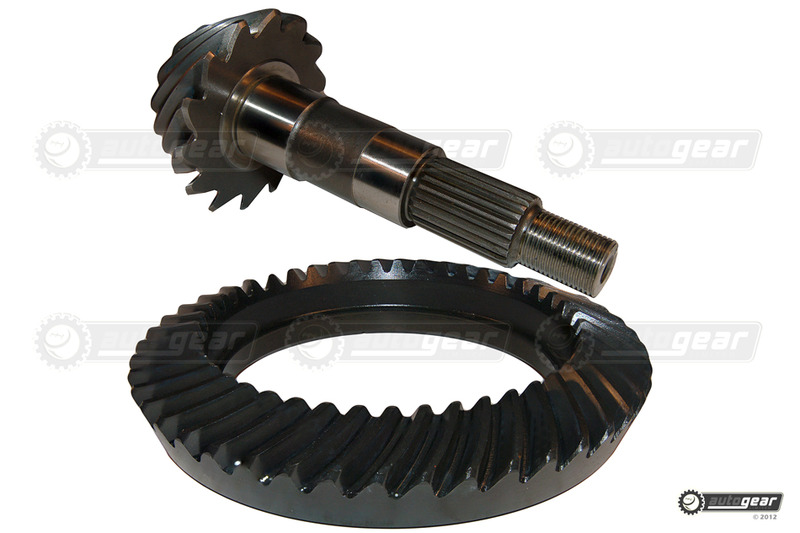

and/or this?
Name:  land_rover_freelander_differential_crownwheel_and_pinion_3_21_ratio_14x45_zps62wpu3um.jpeg

I have a 2003 land rover discovery with 132k miles. I have 270/75r18 bf goodrich all terrain and a 2 inch coil spacer lifts. My tires seem sturdy and have no unusual wiggle movement. When I drive straight my truck is fine nothing unusual. It's when I turn my tires all the way and accelerate that I hear the loud popping noise.(either right or left). Three weeks ago I switched out the front gears in the differential. I literally took off the right and left cv axles and the front drive shaft to be able to take out the gears with the lid that was held up with about 12 bolts. I replaced it with a used one and drove fine. Didn't do any off roading and I never floor my truck. My truck over heated today because it is leaking little by little coolant from my head gaskets. I turned it off as soon as I saw my gauge going up. I filled it up with water turned it on and when I was driving off I made a sharp u turn and heard the lout popping/cracking noise.
