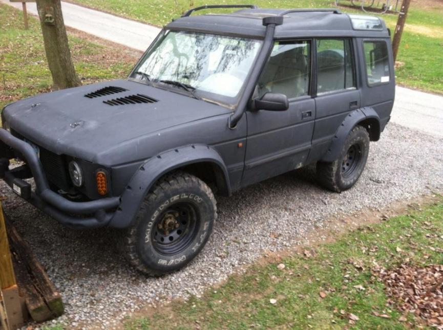

I changed the engine on my 95 Disco and now the transmission is not operational? Thinking that maybe by some freak instance I did not properly install the torque converter I pulled the transmission. After finding that the torque converter was properly installed and full of fluid I reassembled.
The linkage to the transfer case seemed a bit muddy and hard to put into high/low etc.... I cleaned it and oiled the heck out of it. It is still tough as nails to move around. Am I not putting it in gear completely? Seems silly question I presume yet I'm absolutely baffled.
This rover was previously used as a swamp drag truck and we have been working to make it road worthy for 2 years now. It has a lot of mods and stripped all the frills. Yet I really like the vehicle and hate to see it sit.
