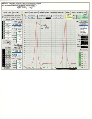

Hey all, okay. So, family friend is ASE certified and we usually take our car problems to him, besides the Rover of course. My parents take their Lincoln Navigator for tune-up stuff, etc. Real good guy. Anyways, while I'm up here at school I had him look my truck over after a few minor overheats and make sure I had a solid foundation to fix upon, I didn't want to buy a new radiator and find out I had a cracked block. Anyways, I didn't need the truck back in any short order so I left him to fool around with it and plug up a diagnostics machine on it. After what began as a simple combustion test he came up with this, absolutely zero CO2 gas in exhaust emissions, as is shown below:

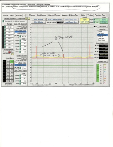

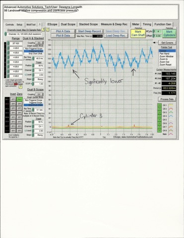

I mentioned cylinder 7 sometimes steam cleaning blah, blah, blah so he ran a relative compression test which resulted in an interesting find. Cylinder 3 is significantly lower than the rest of the cylinders.
Further investigation, significance on Cylinders 3 and 7 for comparison's sake.
This test is ran through the alternator and heavy battery usage is a result. So the battery was charged and test ran again. Results are above what they were, but compression is hardly over 100 PSI, >100 PSI=No Fire (Complete Misfire)
Overview of all Cylinders:
Cylinder 7, healthy:
Cylinder 3, not so healthy:
After frequent scans and manipulating the cylinder in any way possible and listening through a stethoscope it's obvious the amount of air escaping the cylinder was much more.
Diagnosis: Cylinder 3 Piston Ring Leak
This misfire doesn't make itself obvious very much since the cylinder warms up and expands, filling the gap. Every now and again it will be a dead miss though.
