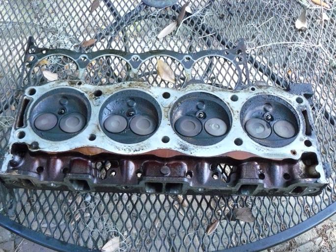

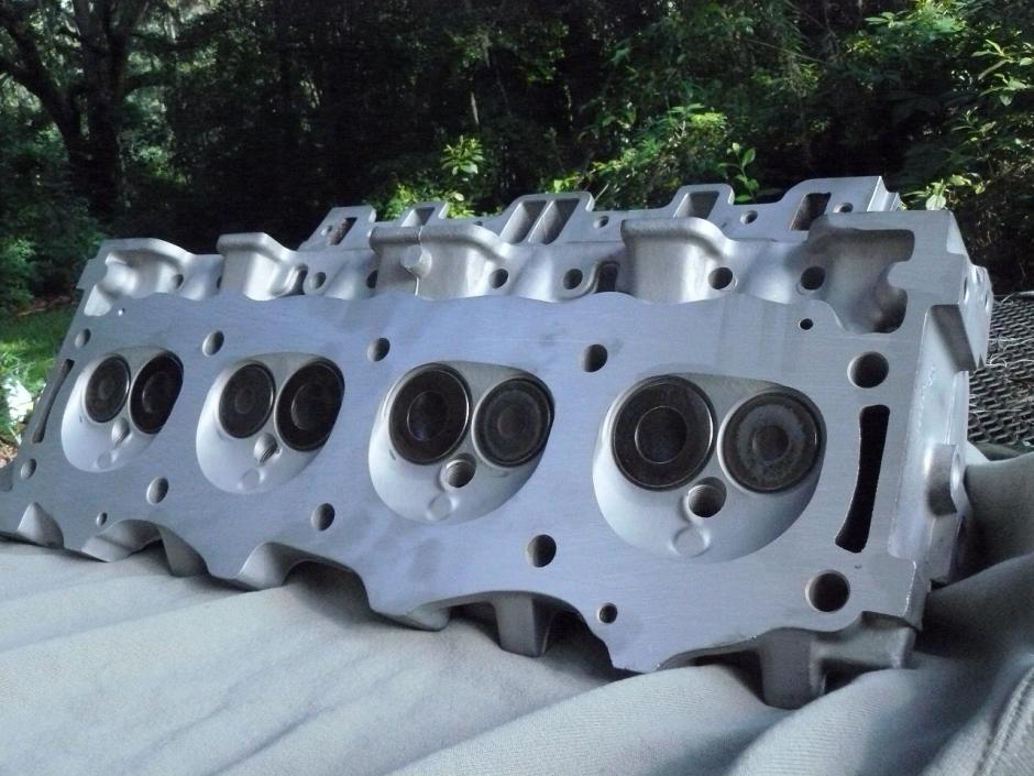

Look at these pix. How much combustion chamber has been removed? Maybe more than I thought.....

You have valves down in the top photo, up in the bottom. May not be as bad as it seems; there's an internet headline right now about a guy who showed how 2 hours of working out, and lighting, could produce "before" and "after" photos that make it look like you should definitely buy that diet product. Worse case scenario, make sure you buy 89 or higher octane (compression has been been inescapably increased when heads machined.) But I personally would not worry.

Yep, I'm gonna look at other photos closer, it may be indeed just buildup.
