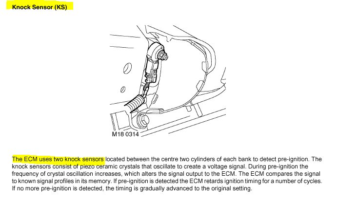

how many antiknock sensors on a 2003 d2 , 4.6
There are 2 knock sensors > Replacing The Knock Sensor On A Discovery 2 Or Range Rover.
Just a FYI, you might want to post a new question like this in the DII Section (this thread is from 2011) you will get more eyes on it.
