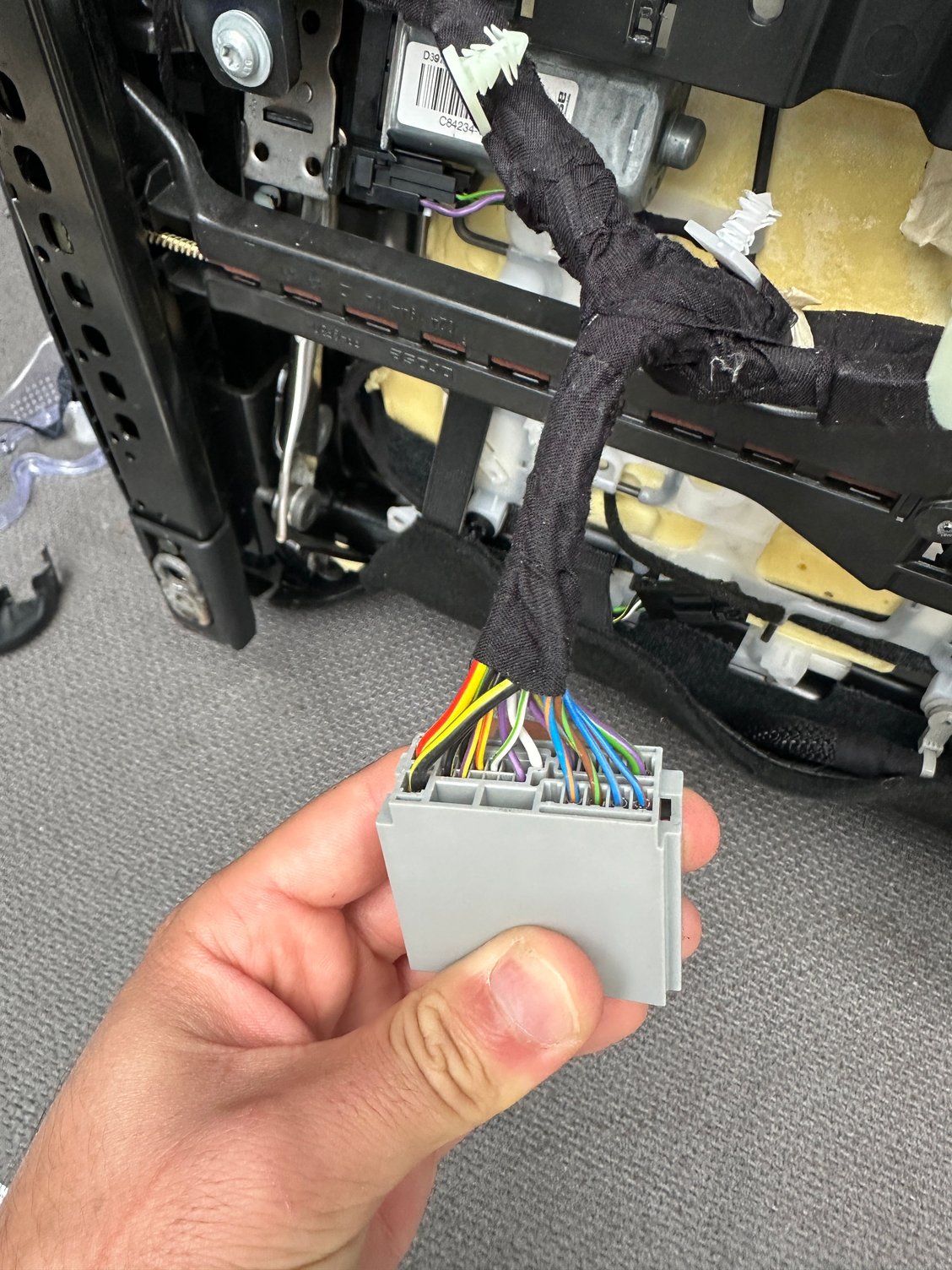

Hi
can anyone help me figure out how to wire a range rover discovery 5 seat to a 2019 sprinter van. I'm trying to figure out how to hot wire the seat to a spare battery first just to get the motor moving forward and backwards. If anyone has a digram that would be helpful.
