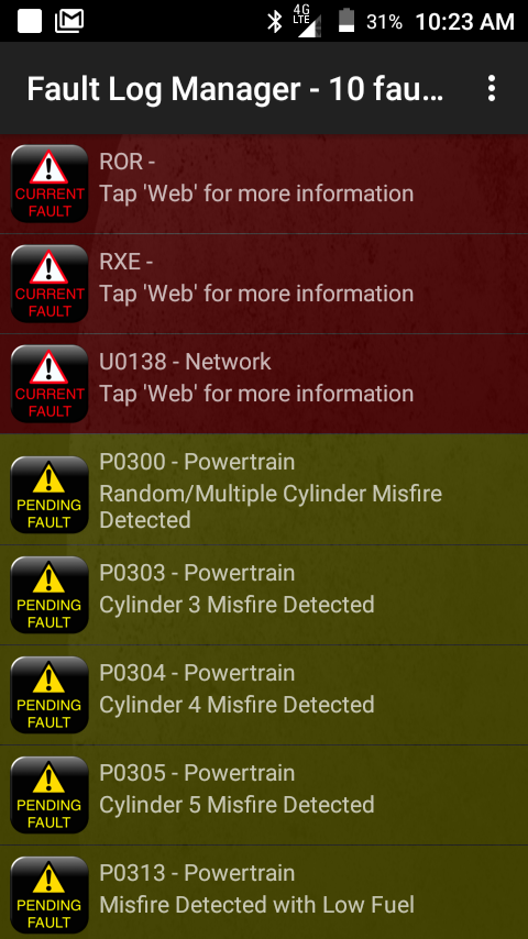

Trying to help this girl get her car back on the road I've scanned it and there are ten codes. I figured since there are so many there is an underlying problem most likely and since I have no experience on these I was going for some advice. She said a mechanic cut her cat off and straight piped cause it was clogged but don't think had anything to do with it. I uploaded some codes and the vehicle just stumbles won't get over 55 and dies sometimes she said. Anyways thanks for reading this and any advice.

Is it an LR3 or a Range Rover?
i would say clogged injectors. Seems all the codes are for misfires or related to.

Try clearing all the faults and see what returns. The "Ignition Circuit D" would be the smoking gun because a faulty coil will cause misfire codes and cause the vehicle to be down on power, however if somebody unplugged the coil doing diagnosis, it could have been set in error.
You can also try swapping the coil to another cylinder and see if the fault moves.
Coil "D" would be the last coil (closest to the firewall) on the passenger side. If you swap it with the very front coil (closest to the radiator), the fault should move to "coil A" if the coil is indeed bad.

It is a LR3. The coil pack and spark plug was bad in #5 and #3. Both have been changed. There was also two valve cover bolts not fastened that have been fixed and attached and that resolved the misfire #4. We cut the cats and put a straight pipe on it before we knew the coil packs were bad and cut then EGR. Is there a sensor that we need to also bypass that will keep the vehicle from detecting exhaust?
It is running ten times better now but there is still a small miss somewhere. It also shows it's getting hot for about 5 seconds intermittently and then returns to normal. Do u think I need a new thermostat?
Anddddd ... it keeps saying low coolant but we had a pressure test done and it didn't show anything yet u could see on the ground where it was leaking. It also hesitates at times to actually turn over and start - u can hear it and if I wait about ten minutes it'll start again. My keybalso gets suck
