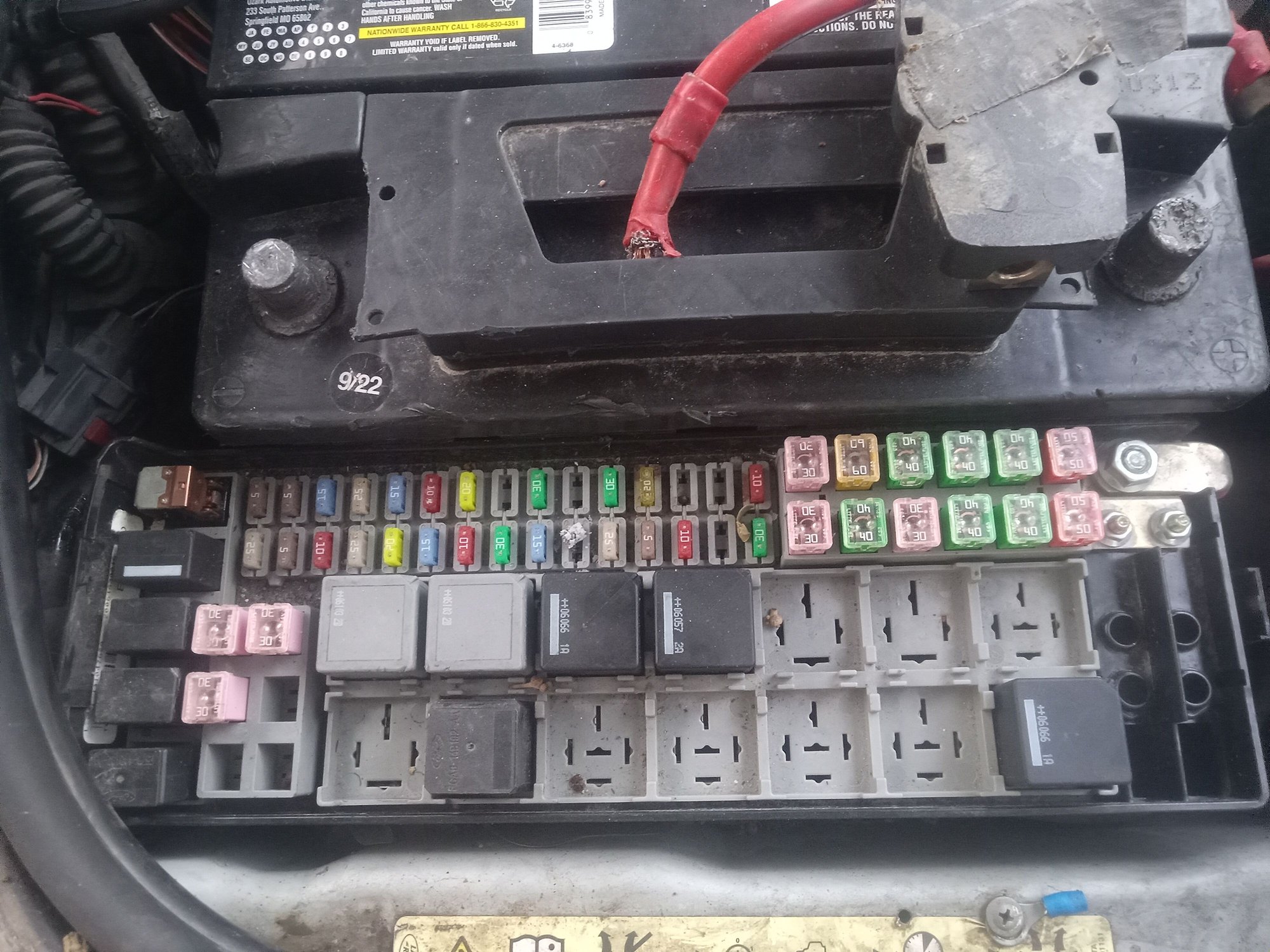

I have a 2006 Land Rover LR3 that was trying to start but won't. I've noticed that alot of fuses and relays are missing and I need to see if that could be why?

You need to start your own thread injuredbeauty...

And post it in the LR3 forum.
