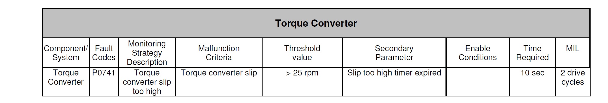

That is a Torque Converter Slip code, which means the computer is trying to apply the converter, but based on input vs output speed sensors, it is detecting that it isn't engaging. It "could" be an issue with the Mechatronics (aka valvebody + TCM) but is usually the Torque Converter itself (turbine shaft seal inside failes, or the converter clutch fails).

No, probably still a converter issue. You likely are putting enough load on the converter clutch in order to maintain 70 MPH that the converter can't stay locked in. I can't say for sure that it IS the converter just based on what has been discussed, but I bet it is a good possibility.
I doubt a Wheel Speed sensor malfunction would cause this. The P0741 fault is indicating there is slippage inside the transmission detected. Its comparing the input speed sensor and output speed sensor, both located inside the transmission. It narrows it down to the converter based on what is applied and the amount of slippage detected.
