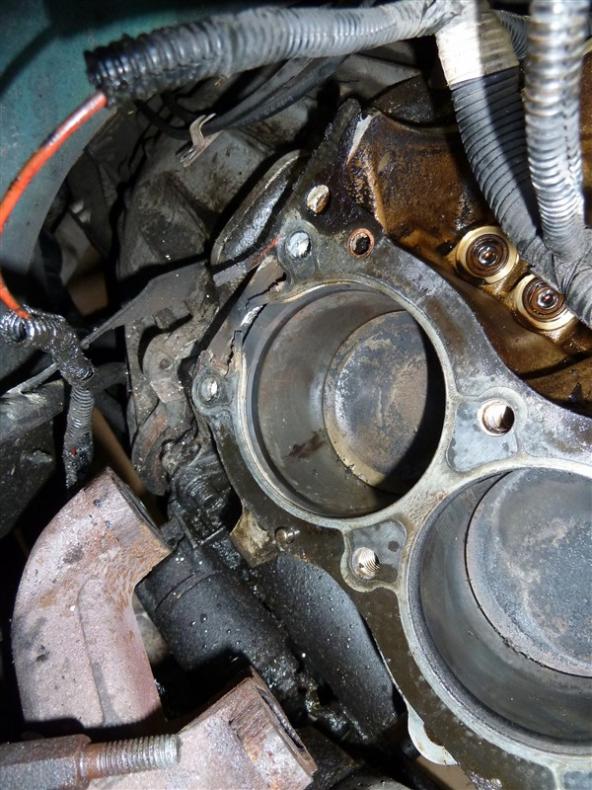

Leak out the rear is great quantity will involve the HG usually. Could also be freeze plugs ( # 1's in attached shop drawing). Can also leak external without any going into cylinder (no white smoke), but your gas test points toward this. So you may find just a new gasket, check heads for flatness. HGs are usually $300 for parts (use new bolts, they are torque to yield "stretch" bolts), and 12 hours.
The Rover is a simple vehicle to work on, and the shop manual set (called the RAVE) is a free download. They are repaired around the world by guys who don't own half the tools you have.
If you can replace a water pump in under an hour on a W124 Mercedes you'll have no problems....
Attached Thumbnails Need help on Family members 98 range rover-hg-rear.jpg   Need help on Family members 98 range rover-hg-rear-2.jpg
