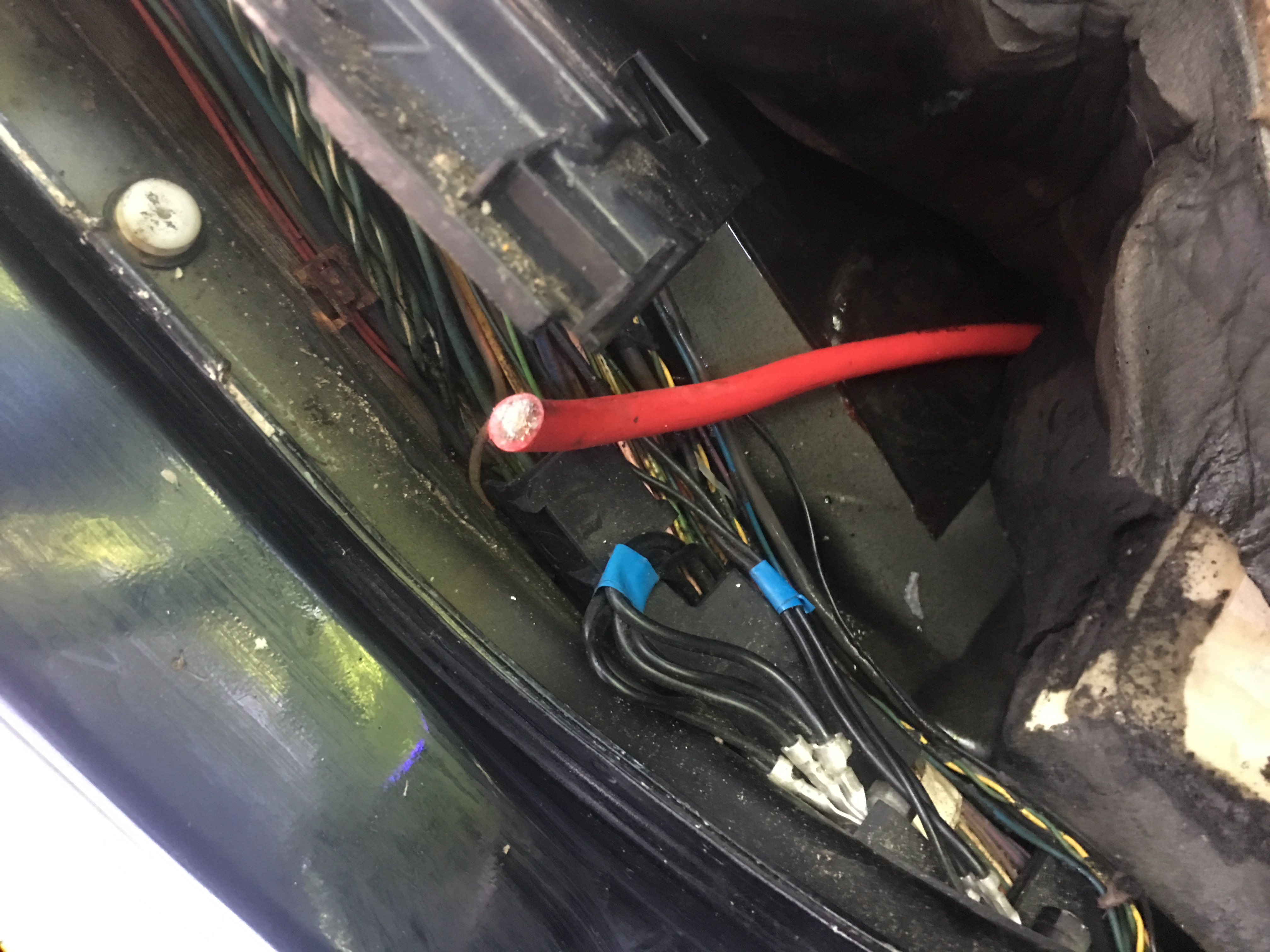

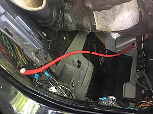

ok below you will see a pic of a positive battery wire coming into the passenger floor board from the passenger firewall near the center of the vehicle, it runs toward the door, but has been cut and no signs of the other piece of wire............... any ideas here. It was laying in a puddle of water that was underneath the carpet. I have used my shop vac to suck it up and have the carpet still pulled back with a fan drying to blow it dry.

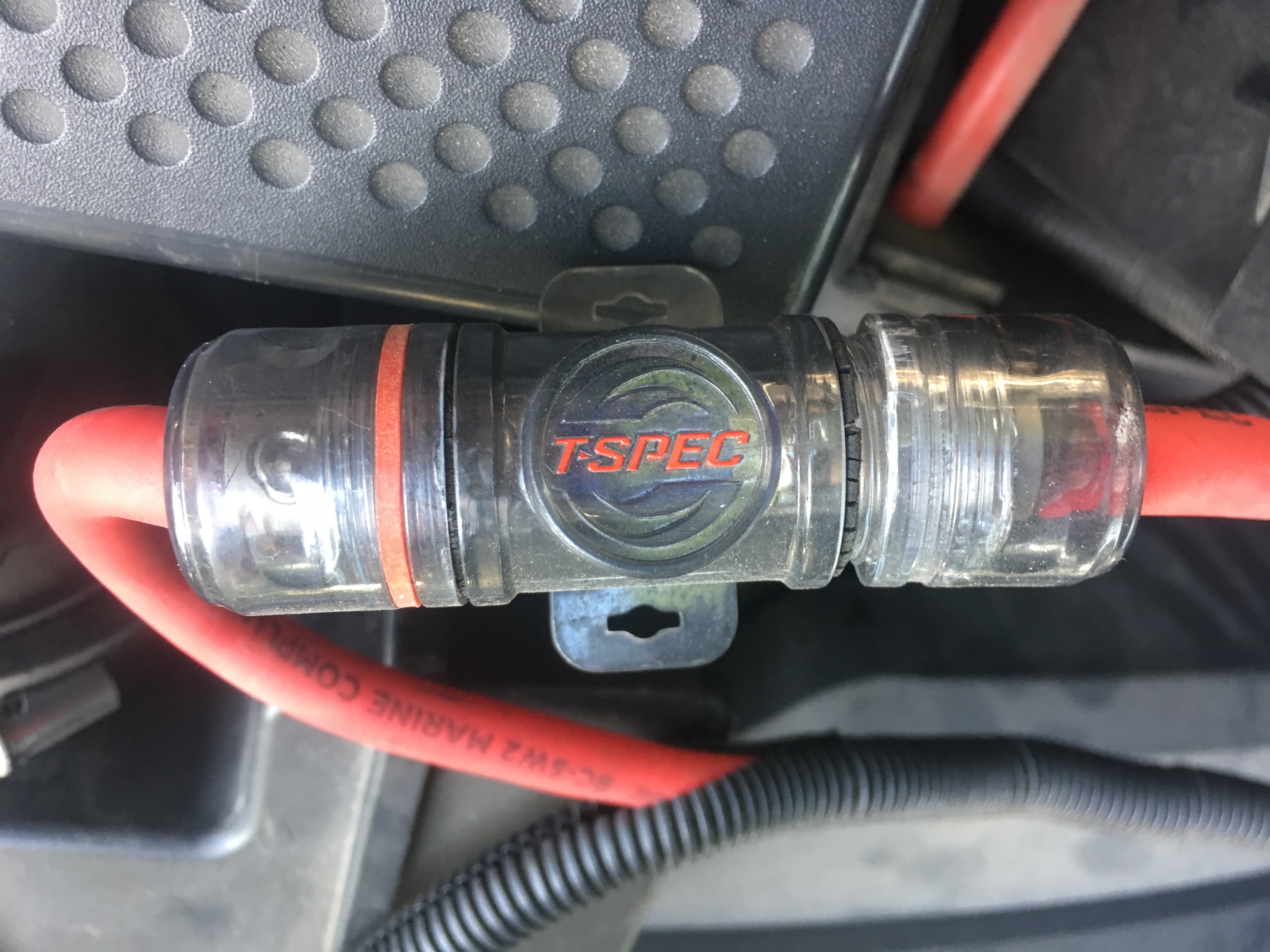

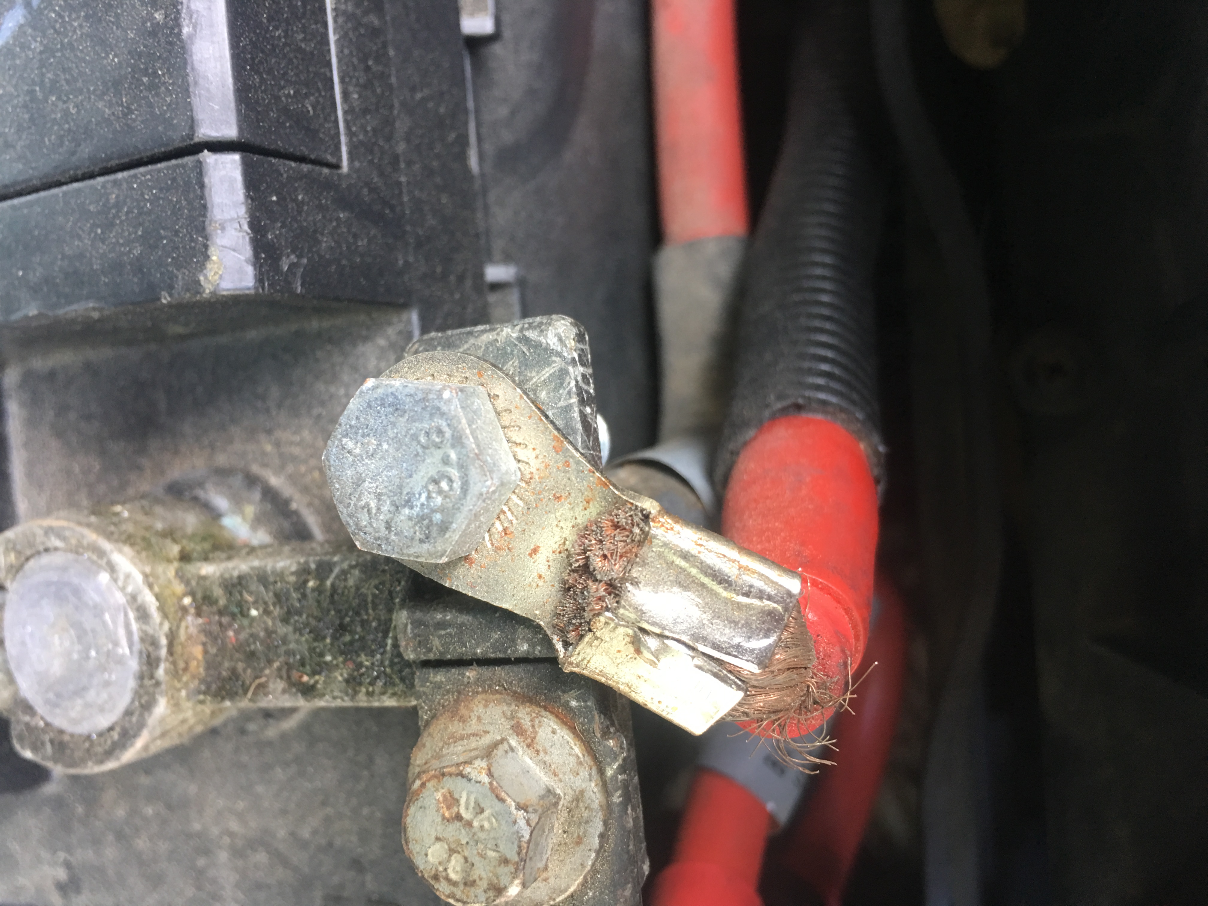

ok, so before I posted this, I went back out and decided to trace this wire. It comes up through the firewall and attaches to a TSPEC Fuse holder which then runs to the positive battery terminal. I am assuming this was to run an amp or something that may have been in the back of the vehicle. I have pulled it completely out and detached it from the battery terminal.

There are a billion wires under the passenger door kick plate. Looks very intimidating. How in the heck to you go about checking all these wires?
