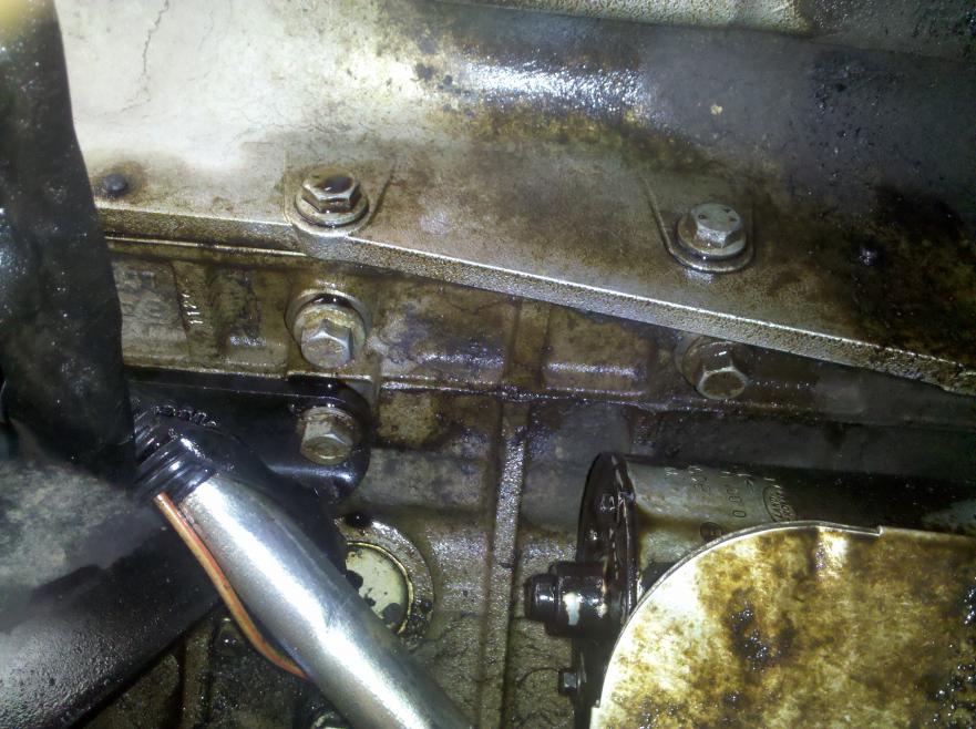

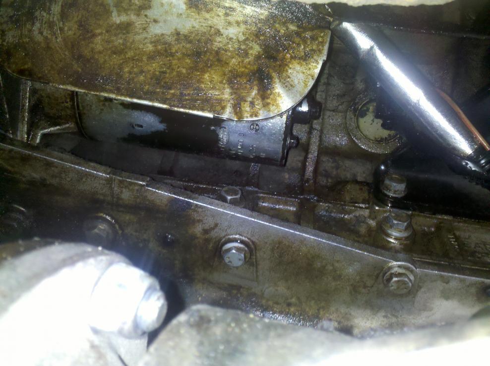

Ok Mike this is pretty much directed at you. I'm gonna try to attach some pictures with this, but I'm not that computer savvy so we'll see how well this works out.
Mike since we talked, I have changed the oil including an engine flush and installed a K&N 3001 series filter. I gotta say, 13$ for a filter is outrageous, but worth it if it helps save my oil pump. (and Autozone has a pretty sweet deal going right now on Syn oil and K&N filter for like 26$, I bought two!). So oil is changed, engine was degreased and power washed clean. I have been checking my oil regularly and just had to add more oil yesterday. The underside of my oil pan, and what I think is the starter is covered again, as well as that entire area of the engine.... and I noticed that there was oil, just a BIT, leaking from a bolt I tightened today. I don't know enough about mechanics to know the bolt I tightened, but I took pictures. I checked most to all of the bolts around the "oily" area and they were tight. You can't really see any oil from the top side of the engine, but it is very apparent from the underside. I checked the oil filter, and around some gaskets, but I have no idea where to start looking now. I'd like to have a pretty good general idea before I take this thing to a mechanic and pay out the @$$ to get it fixed. Any ideas? Mike if you still have my # feel free to call me, if not PM me and I'll send it to you agian. Thanks guys

Ok here are the pictures I was talking about. Sorry if they're upside down or not that clear. But this is the area I was talking about. You can see the bolt I was referring to, close to the starter, on the side of the "engine". (I don't really know what I'm reffering to). I noticed the oil had leaked down the tubing pictured and dripped onto the top of my diff. I looked around, but the area pictured is where it seems to be coming from. Any ideas? i can take more/better pictures if needed.

Go do a total engine degrese and power scrub so you can find where the oil is coming from. Do a complete top to bottom clean, make sure the valve cover bolts are tight.
Let us know where it starts leaking from afterwards.

Like they said, clean it again and check after a few miles. Don't wait for a quart to leak out, find the leak when it first starts so there isn't oil spread all over making it more difficult to pinpoint the source.
