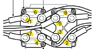

Hello, I recently changed my coils plugs and wires . Hooked all back up, followed several diagrams for plugs to make sure they were all correct . fired back up to watch and listen to it sputter and die horribly ! Sounds like wires were crossed but it’s impossible as I have checked 5-6 times taking off manifold and putting old wires and coils back on for Same results .. ran fine before I swapped everything out besides a small misfire in cylinder #2 so I decided to do the whole service to save a headache in the future . But now I’m at a dead end and utterly disappointed in myself . Also plugs smell and look like they are drenched in gas from uburned fuel going into cats ! Tried to crank several times but just won’t run but a second and sputter put put poot cut off . Help me rover gods ! I don’t want my rover to leave !

You are best off posting in the D2 section to get more eyes on the question. Here is the diagram in case you want to check it one more time. This view is what it would like from the interior of the cabin while looking at the back of the intake manifold.
