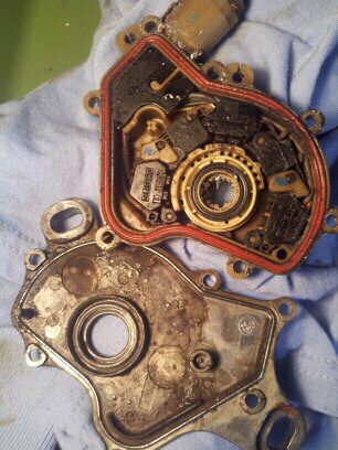

Old Aug 14, 2012 | 03:28 PM
Posts: 16,322
From: Savannah Georgia
As you will find in your very own copy of the RAVE, it is under the driver seat (NAS).
Should survive if unwatered and dried out, including connectors.
There is also the XYZ switch on the side of the tranny, it tells ECU what position the shifter is in, and if it is full of water can do similar things. It can be removed, opened up, cleaned up, resealed.
The normal ratio between "thrill time" and "shop time" is like 1:50.
