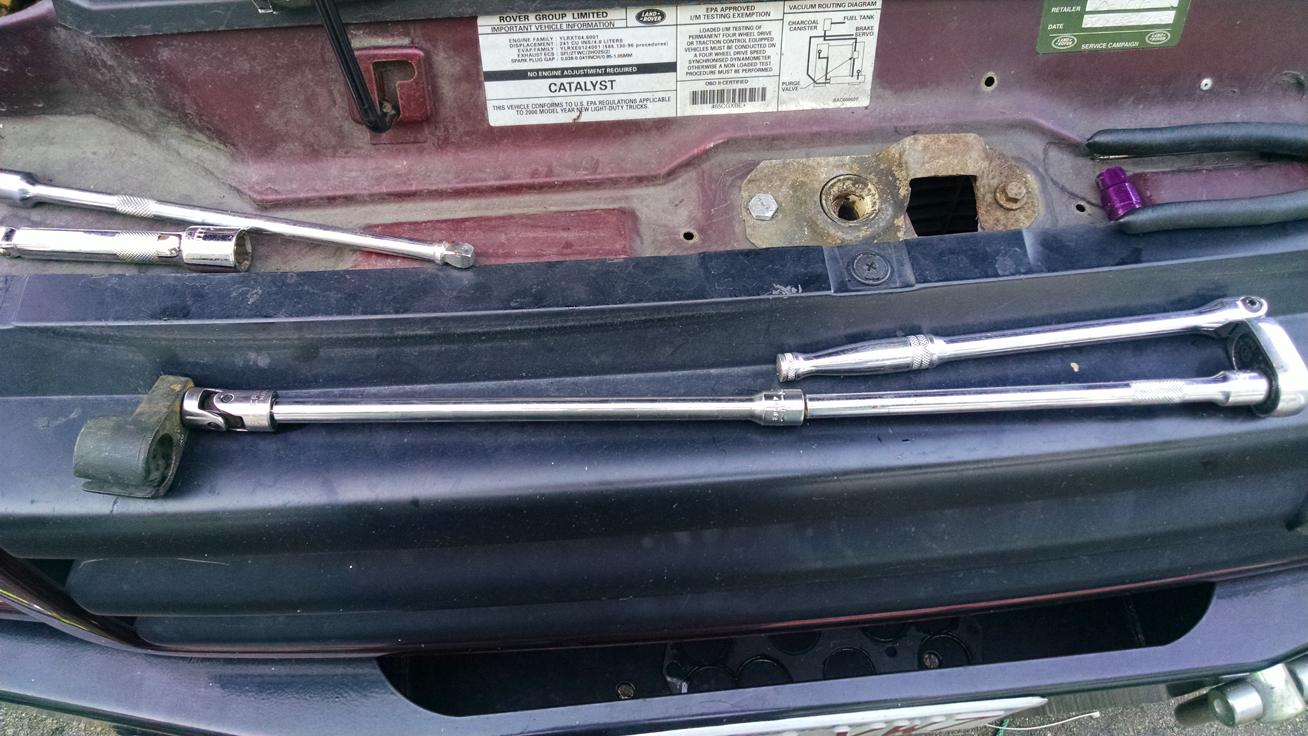

I have been trying to get this darn o2 off for 2 days now... tried PB blaster, heat so hot I could barely be under the truck and the wd-40 rust penetrating spray... I have the special o2 knock tool (the one you either hit with a hammer or put in a 3/8 in drive socket extension in... It's not budging.

they can be a bitch, heat doesn't really work because they have been heated and cooled a thousand time. i had luck heating the trucks up spray them with SeaFoam DEEP CREEP, then going after them. If you are using a standard o2 socket they can be a bear a lot of times it will only budg the sensor a hear and you have to keep resetting the socket.
are you using one of these: if so you need a bigger ratchet

I'll try a set up like that, I was just underneath hitting the socket you have in the picture with a 2 lb. hammer trying to break it loose. I may have more luck with a set up like you show in the picture!

Drowssap, You sir, are a lifesaver. I used your setup and got it done within 20 minutes. Replaced it, cleared the codes and went for a drive.. Came back and rescanned and the code is gone gone gone. Hopefully I will see an increase in MPGs thanks man for all your help!
