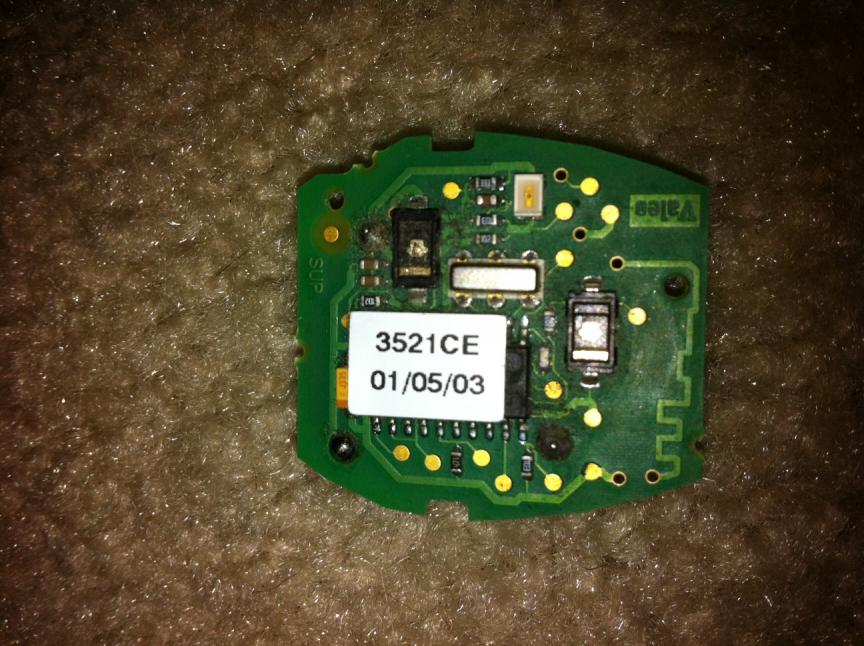

This is my Second Disco 2 with this problem. The usual plastic key head damage (buttons are blown out)
I ordered a couple new keys and the remote insert will not lock or unlock the doors when I insert it into the new key blank.
It WILL lock and unlock the doors if I bridge the tiny brass contact points in either the lock or unlock switch points with something like the tip of a small flat tip screwdriver................Look at my picture; the lock and unlock switch points are the small vertical black plastic rectangles with the round contact point near the top,....and a narrow horizontal contact point near the bottom.
I'm thinking that there must be a small spring-returned contact strip that the plastic buttons press on to bridge the two contact points.
I've attached a pic.
Any thoughts on how this can be fixed short of buying a new remote module?
Brian

if you search thru ebay there is someone selling a new case w/ the new button you would have to soldier them in place

I already have those,.....they don't work, as they don't include the metal contact to bridge the two copper contact points on the remote module. Identical issue on my last Disco.
Again, I can activate the remote module and lock/unlock the doors, if I bridge the copper contact points on the circuit board with a tiny screwdriver tip.
Anyone found a fix for this?

Drowssap: I eventually figured out that you were actually referring to what I bought,....replacement micro switches that need to be soldered on to the circuit board. Your "soldier" threw me for a loop. Didn't know what you meant,....doh!
Finally got around to ordering the replacement key with 4 replacement contact buttons. I didn't want to attempt soldering something this small on a circuit board. Stopped in to a local "Batteries +" last week to see if they wanted to attempt it since they solder batteries packs every day. They couldn't guarantee it would work,.....but I was confident. It took them about 15-20 minutes of fiddling with it,....one of the solder joints was not flowing properly. They finally got it to a point where it was functional, albeit,......a bit ugly. They didn't charge me anything to do it,.....said they didn't want me coming back being if it failed after a bit......lets hope it holds together. Now just gotta repair or replace my driver's door lock actuator.
