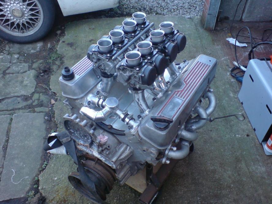

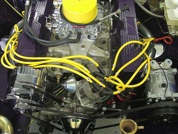

IMHO I'd be kinda scared to put my D1 on a dyno and see just how low it is... besides, ours are built for bouncing thru Borneo, not bleach burnouts at the track. Until you start down these paths..
Attached Thumbnails Air filters-1995_range_rover_classic_swb_supercharger_eaton_m62_for_sale_engine_resize.jpg   Air filters-rickingram-bb.jpg   Air filters-firebladecarbs.jpg
