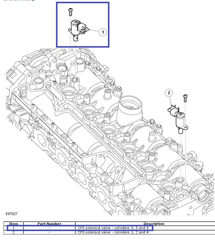

You also have a code for P003D
P003D - "A" Camshaft Profile Control Stuck On
Link showing a failed Solenoid https://www.freel2.com/forum/topic33...light=solenoid
Note: The profile switching needs oil pressure to operate
In this case the error appears to be related to
CPS solenoid valve - cylinders 3, 5 and 6
The solenoid could be bad
Note: the orientation of the sketch the visible ports are the exhaust side not the intake side
If I had your problem I would switch the CPS sensor and see if the codes go from 3, 5, 6 to 1, 2, 4
