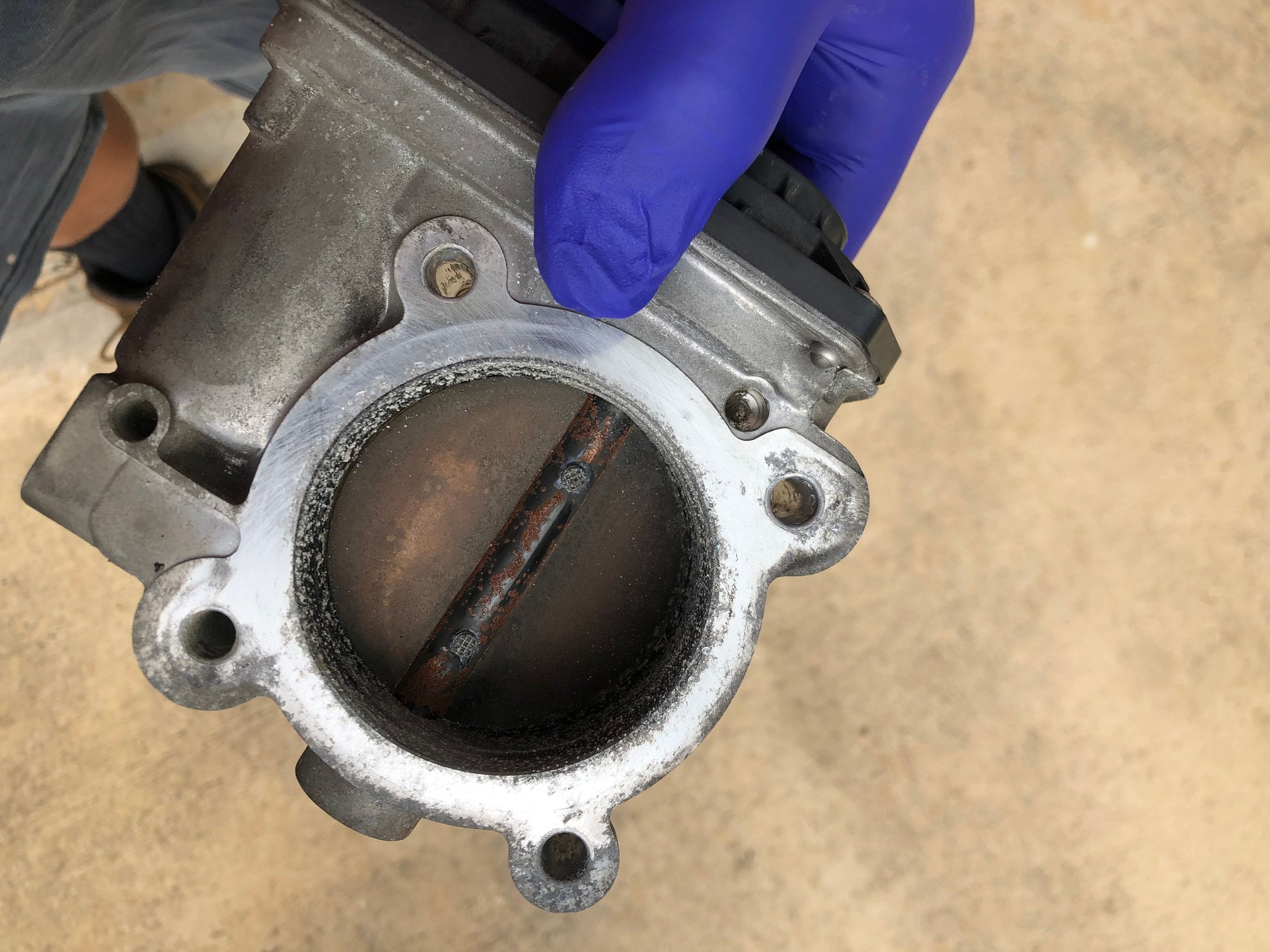

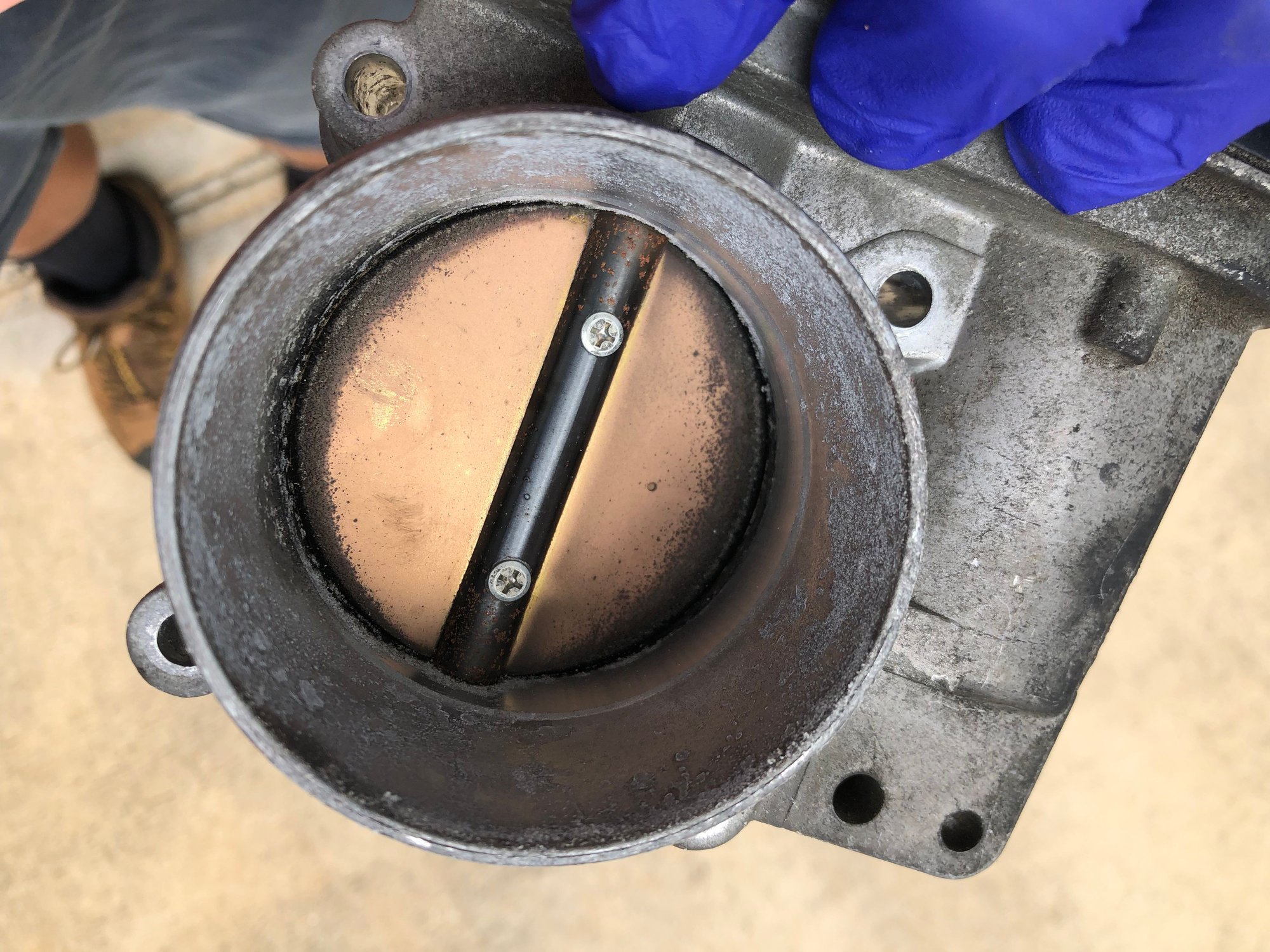

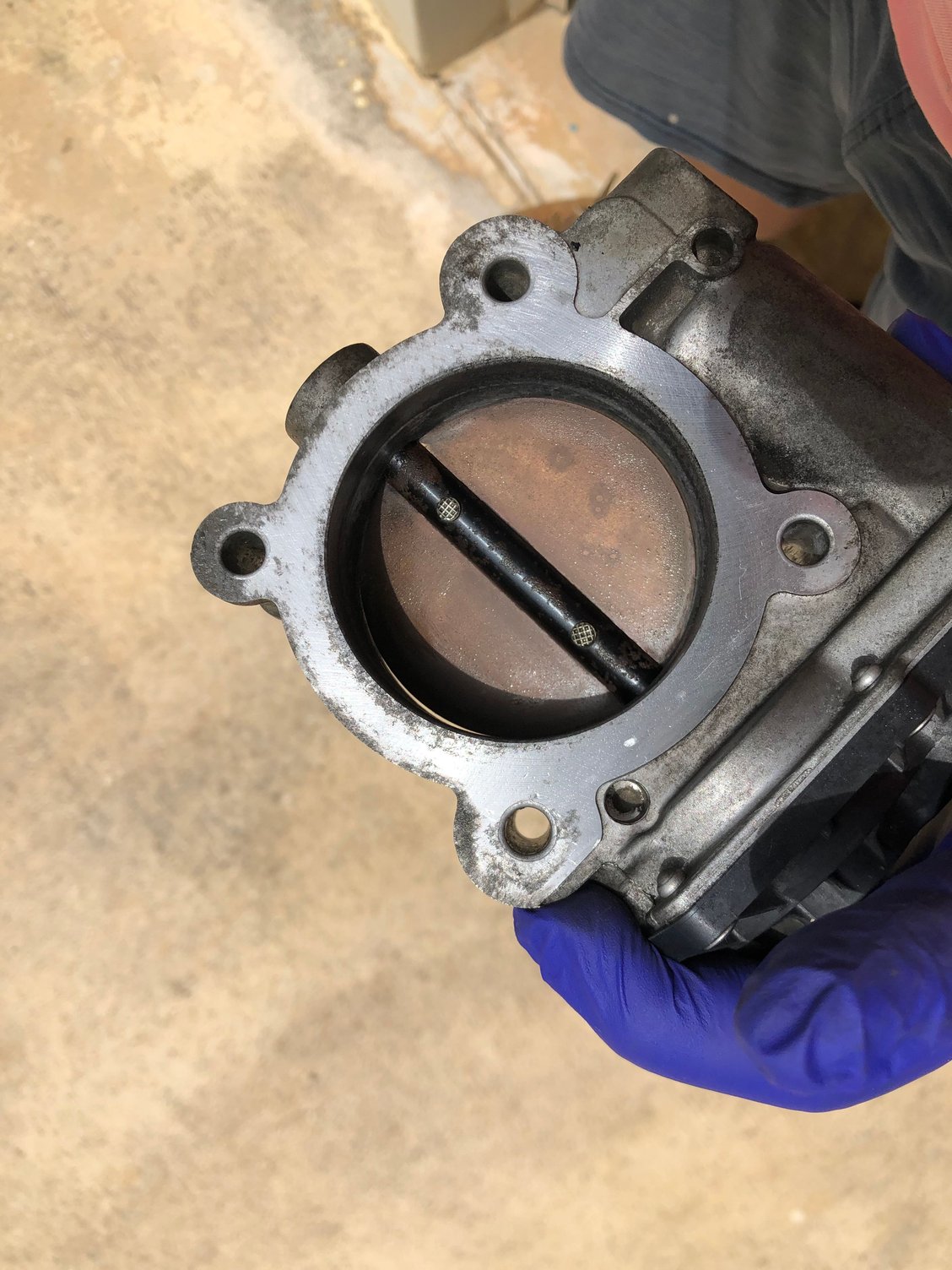

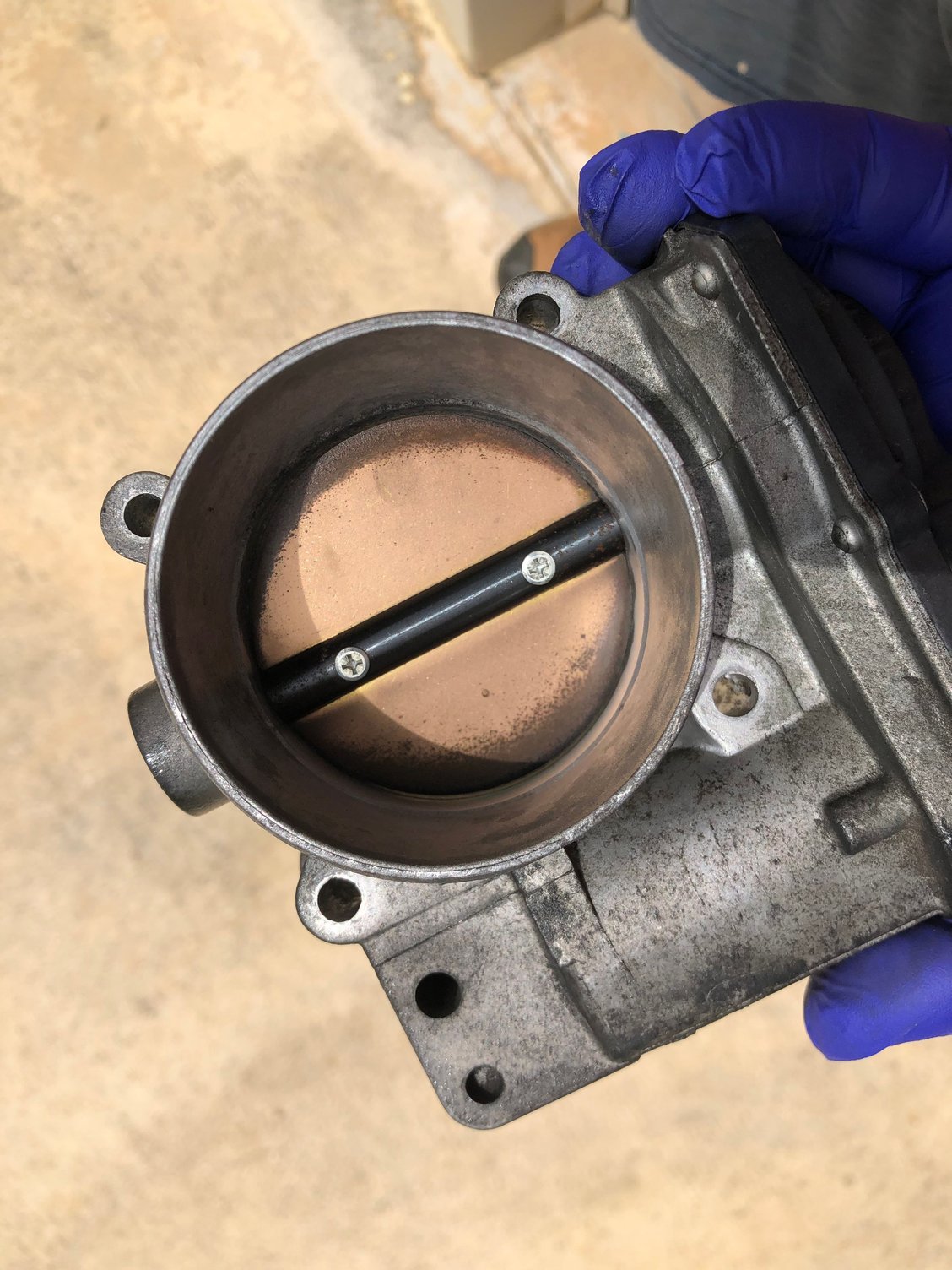

Yes, i think you are right. Apparently yes, I made a mistake in cleaning the throttle body, or when reinstalling it. But if you will allow me, I want to ask something else, in reference to the cleaning method. I want to know if I clean the throttle body well, because in some you tube videos, I observed that people turn by hand, the internal circular piece of the throttle body for cleaning it and I did not dare to do it. Should I rotate it, for a better cleaning? To illustrate my question, I am attaching 4 photos, the first two are from the recently uninstalled throttle body. The other two are after cleaning. Please, watch them and tell me what you think, because i know the cleaning can be better.
Thanks!
Pic#1 before cleaning
Pic#2 before cleaning
Pic#3 after cleaning
Pic#4 after cleaning

My gut feeling is that all that corrosion and residue probably means the motor is giving up the ghost. I'm surprised at how dirty and rusty it was. In what part of the country do you live?

I am also from Puerto Rico, though I live in the mainland now. In that case I strongly advise you to change the throttle body, and try to get in the habit of using anti-corrosion sprays on any surface of your car susceptible to corrosion. I spray my entire engine, EVERYTHING in the engine compartment, with WD-40 every 3 months or so, especially in the winter when the roads are full of salt. I also try to spray the undercarriage as much as possible. Most people don't understand WD-40 is not a lubricant, it is a "water displacement" formula intended to protect whatever it is sprayed on for corrosion. If that car has lived all its life in PR then it might have other problems related to salt water spray corrosion. You really have to be proactive to protect your car from that.
