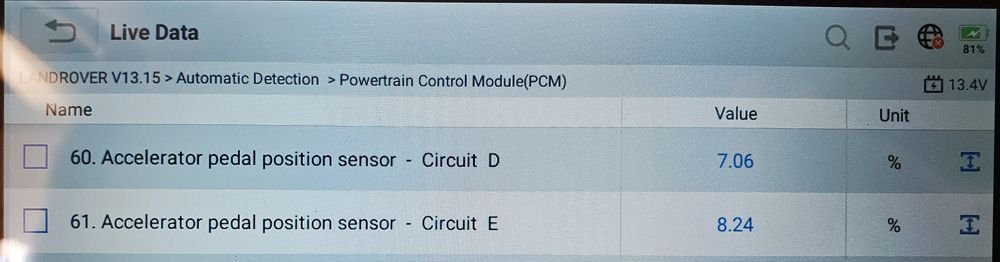

I have an 08 LR2 and checked the Live Data sensor readings using an XTool OBD2 scanner (screenshots attached). As previously stated by others, a healthy battery and alternator are a minimum requirement before any of these readings can be relied upon.
For the pedal position sensor, not depressed, circuit D is 7.06 and circuit E fluctuates between 7.84 - 8.24.

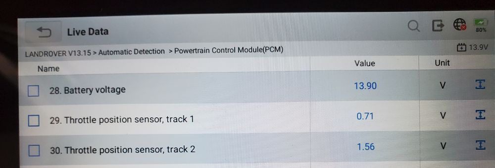

Code P2138 may also indicate a problem with the throttle position sensor on the throttle body. With the pedal not depressed at idle, sensor-1 is 0.71 and sensor-2 is 1.56. So sensor-1 correlates at approx half of sensor-2.
Your pedal sensor readings match mine closely. What are your throttle sensor readings?

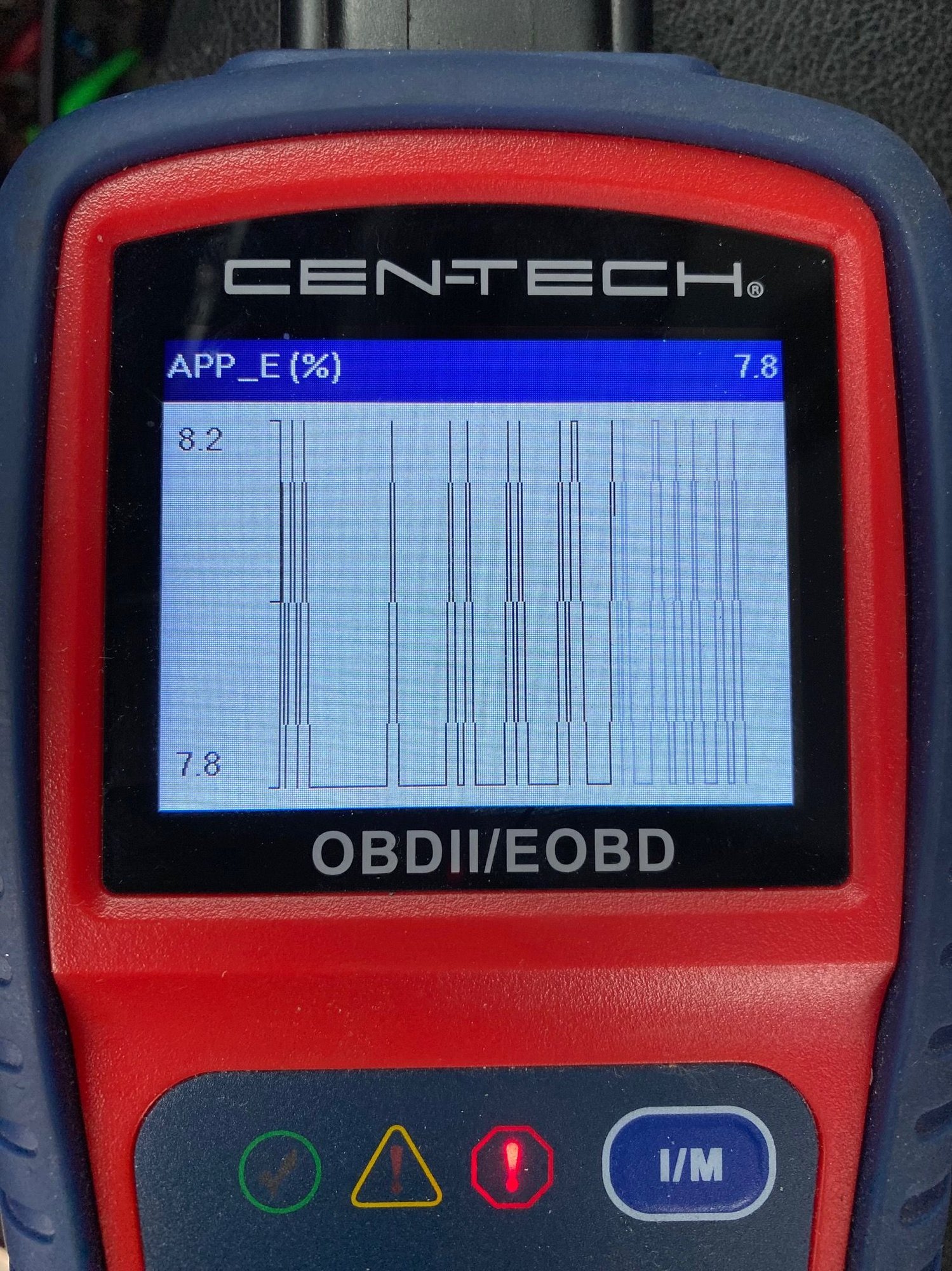

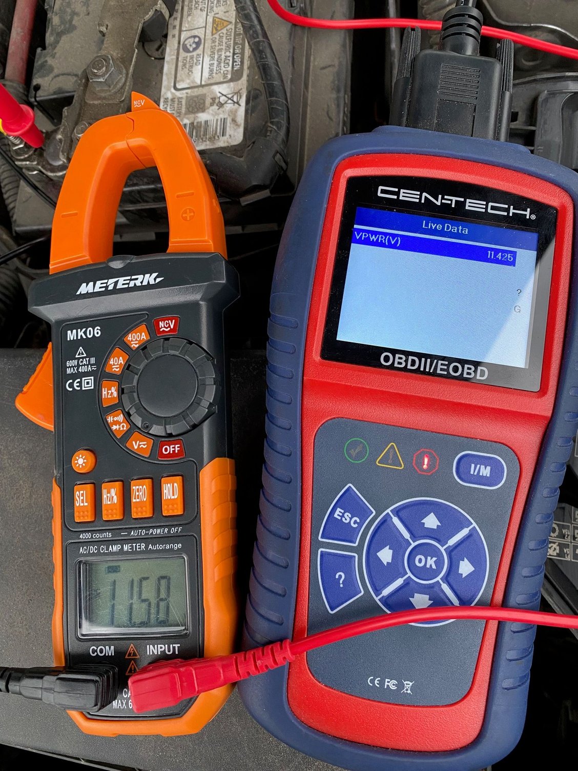

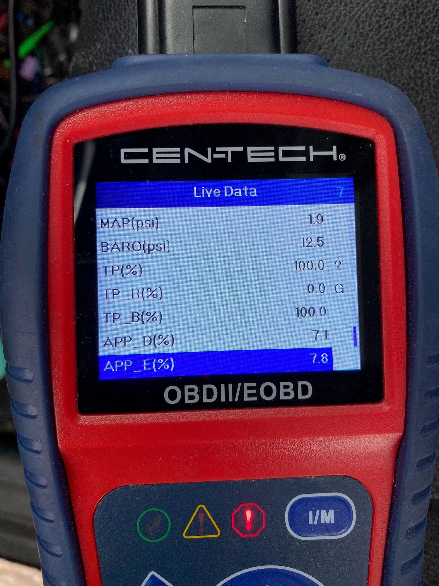

LR2 Driver, thanks for checking yours readings. It sounds like the APP_E signal fluctuating isn't abnormal. Below are photos of the scanner readings you mentioned plus a few others. I'm not sure if the TP_R and TP_B not being the same is an issue. This is just key on since the engine won't start. If you all say a weak battery can cause the sensor readings to be unreliable I won't chase any of these until a new battery is installed.
MAP, Barometric pressure, Throttle Position readings, APP readings
APP_E signal graphed

Battery reading and scanner reading for controller voltage with key on

Your TP_R and TP_ B readings are the angle positions of the throttle body. They are different measurements than the throttle position sensor readings I provided which are related to code P2138.

Old battery was tested and the cranking amps were about 700, so a little weak but volts were above 12 so the kid at the FLAPS said it was fine. I went ahead and purchased and installed a new AGM battery anyway. Still have Engine Performance Reduced message on dash with key on. The first time I try to start it after connecting the battery it will fire a few times but sputter and die after maybe 5 seconds. I checked that the alternator is spinning when the starter is cranking.
I used the scan tool and it still had some active codes in the memory so I cleared the codes. .The live data still shows the MAP at 1.9 psi while the barometric reading is 12.5 psi. I know this was an issue a few months ago that was corrected with a new MAP sensor so I have a replacement on order from the FLAPS. The voltage reading from the ECM was at 12.2 volts with the new battery instead of 11.8 volts so that is an improvement.

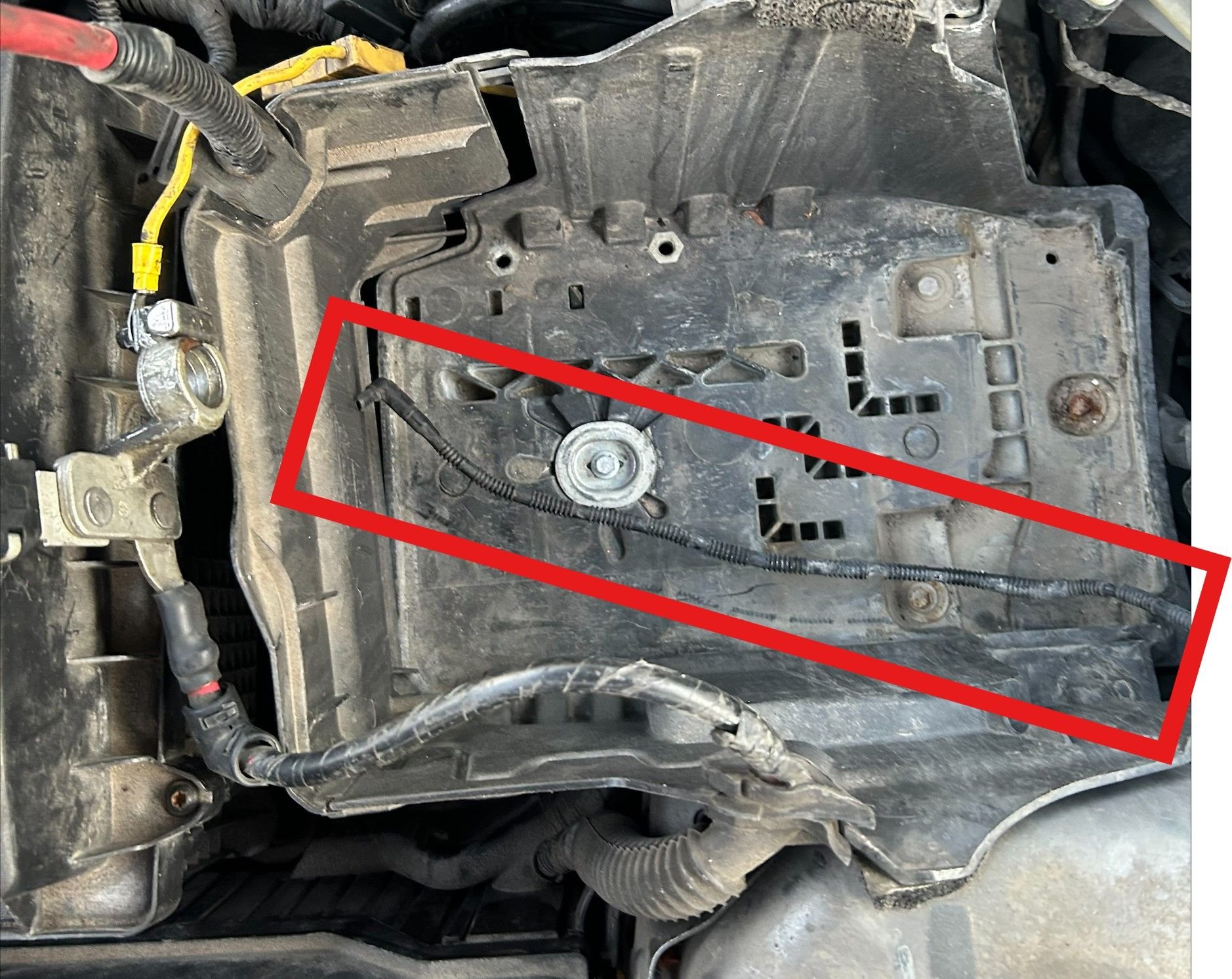

When I removed the old battery there was hose underneath it (see image below) that doesn't look like it should be where it was. I'm not sure where it is supposed to connect. Any suggestions?
Mystery hose in battery box

Your AGM will have vent holes at top short sides, that hose is inserted into any vent hole and the BMS monitors and adjusts.

I rechecked my code scanner and TP, TP_R, and TP_B are the only readings I see related to the throttle position. It is a budget scanner so I guess a shouldn't expect too much out of it. When I click the Okay button when one a line is highlighted it gives a brief description. It says TP is the Absolute Throttle Position and TP_B is the Absolute Throttle Position B. If I understand correctly what you are showing is the signal voltage back for each of those instead of the position reading.
