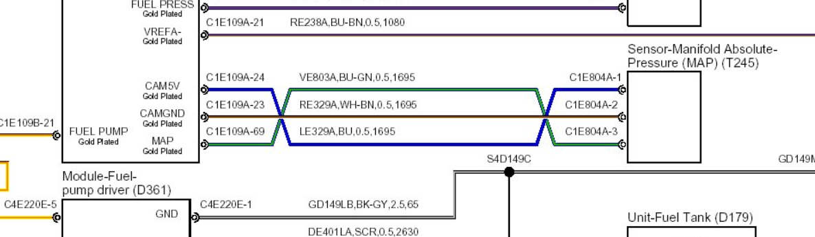

With a new battery reading 12.5V with key on I still have Engine Performance Reduced on the dash and it will start and turn over a few times on its own. Because of the OBDII scanner showing the MAP reading so low (1.9 psi compared to the Barometric reading at 12.5 psi), I suspect this is at least part of my issue. I have plugged the scanner into a couple of other vehicles and all of them the MAP and Barrometric readings match each other. If I remember right they were all about 12.5 psi for both MAP and Baro.
I decided to back probe the sensor connection. The blue wire is only reading 40mV and based on the wiring diagram it looks like that should be the 5v supply. The blue/green wire is reading 0.48V. I replaced the MAP sensor and the MAP reading is still 1.9 psi.
screen shot of Electronic Engine Controls sheet 2
I wiggled wires while I had my daughter watch the OBDII MAP reading to see if it changed but so far nothing changed it. I plan to check continuity from the ECM connection for the blue wire to the sensor connector. Any other suggestions of tests? Am I jumping the gun again like I did before replacing the battery?

What are your current OBD2 codes since you last cleared them? P0069 indicates a deviation between the MAP and Baro.

There aren't any active codes but the pending codes are P0069, P2138, and P0642.
The P0642 seems like it could be because the voltage at the MAP sensor isn't 5 volts.
