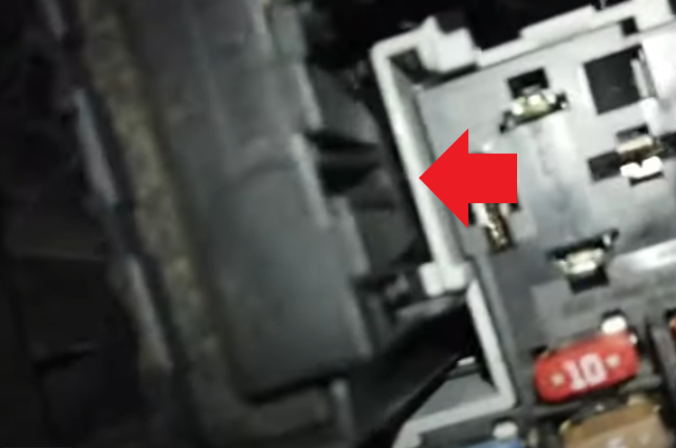

The red arrow points to the locking tab (the relay has been removed, but this is a capture from a youtube video). You will need to gently push the tab out (to the right in this image) to unlock the cover.

The fuse for the fan is F3. It's under the little cover he was asking about.

Thanks. Got the adjacent cover and cover needed off F3... a strap fuse that has perfect continuity. So fuse good.
