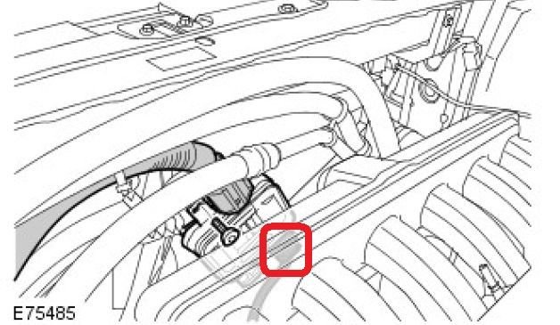

The oooling fan module can be removed without removing the cooling fan assembly or radiator. Disconnect it and undo the screws.

Getting that fan plug disconnected from the bottom side of the fan module is difficult. The intake manifold doesn't allow much room to reach in. I'm working on some creative solutions...

It's not difficult, you just need the right tool, the same tool I used to use to change the headlight bulb on my Mercedes ML550, where the owner's manual said to take it to the dealer.

I thought the front bumper is normally removed to replace the radiator. For the fan replacement, does the intake manifold need to be removed to make working room?
