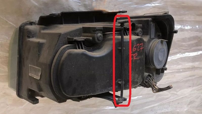

This bulb replacement is simple enough: Remove the two 10mm bolts at the top of the headlight assembly, pull up on the plastic release tab, and slide out the assembly so you can access the bulb socket.
Unfortunately, one of the plastic release tabs broke off when I pulled up on it, and then I noticed the plastic rod was also broken near the bottom. I don't think I applied too much force, it may have become brittle with age.

This is the rear view of the headlight assembly showing the plastic release tab and rod (I borrowed this photo from an eBay listing).

Good info! I didn't know this release rod was available as a separate item (LR001547) from the larger assembly.
