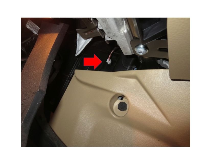

Originally Posted by LR2driver
I'm going to remove it (LR003200) for a bench test. It appears to be one of the few items that's actually easy to remove and replace.
Update: I could not find specs on this particular Evaporator Temp Sensor so I ordered a new one to make a comparison. The result is they both behave the same under changing temps.
As an NTC thermistor, the resistance increases when the temp declines. They measured approx 2.5K ohms at 78F, and 5K ohms nearing freezing. This precise scientific testing was performed in my refrigerator/freezer, so don't attempt to reverse engineer the specs from these measurements. It was just enough testing to convince me that my old unit works.
For reference, the OEM part LR003200 appears to be identical to a commonly advertised sensor by URO Parts 2108300772. You can pick it up for less than $10 online.
It was easy to remove/replace. The connector with two brown and pink wires is in the driver's footwell to the right of the gas pedal (see photo). I could access it without removing the panel. Use a small plastic trim bar to pry it off.
Now I have a new replacement as well as a working spare.
