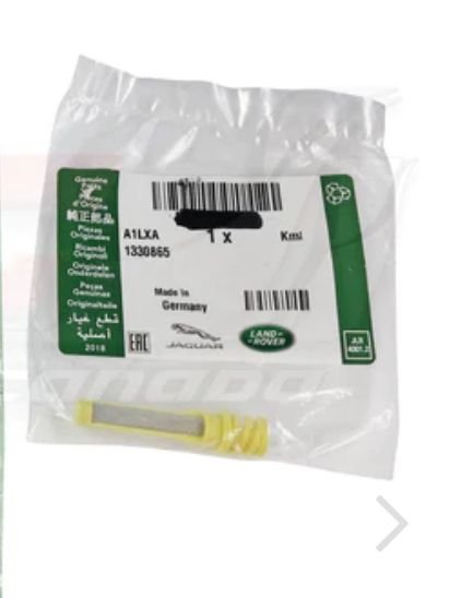

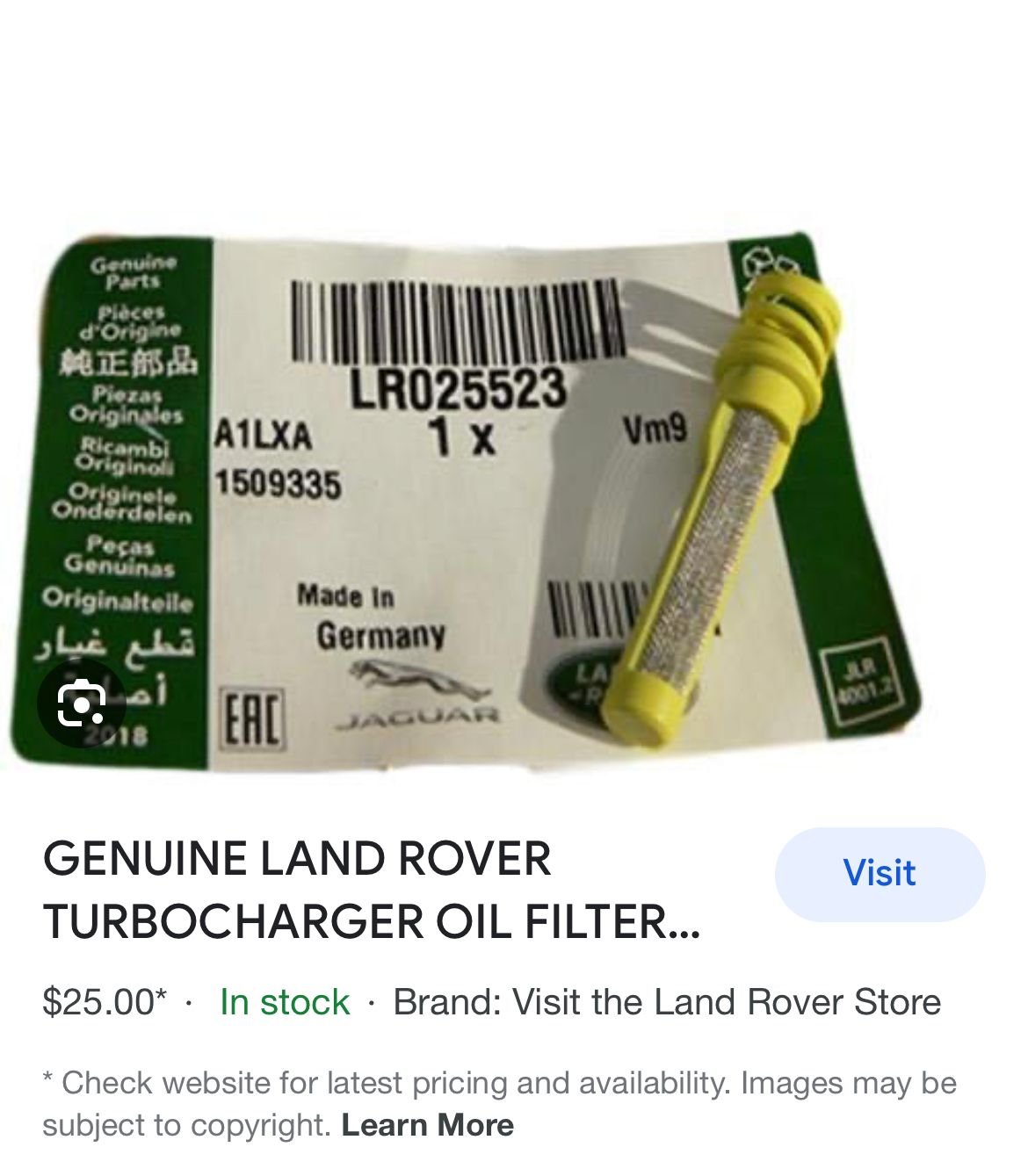

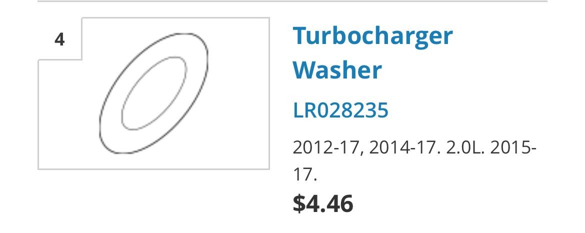

You need 4 brass washers. I would get one more of those double washer things. As I am sure I replaced 4 of those. And an oil inlet filter.
ourx15 - I am having a hard time tracking down the oil inlet filter. I tried the part number on the photo you provided (1330865) but nothing comes up. Is there another part number somewhere that I'm not able to see? Thanks

I just went to Land Rover dealer and asked for one. They have them in stock as they replace the manifold often.
