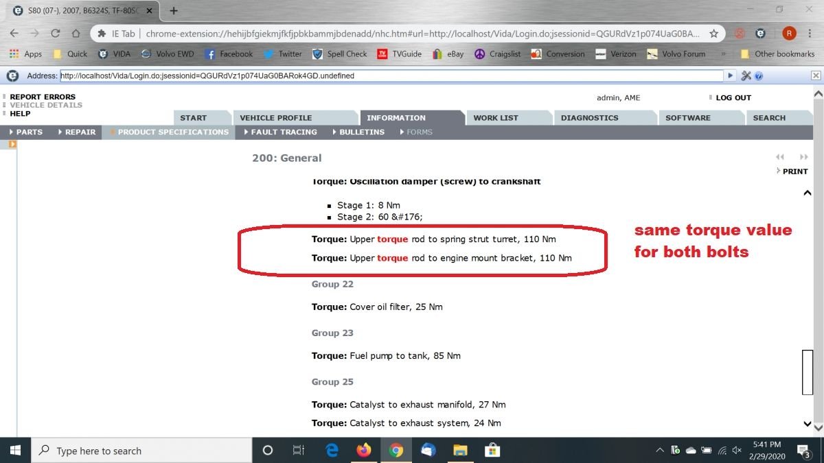

Yeah, there are so many more Volvos on the road than Land Rovers with this engine that Volvo can be a better resource. I did not find the Volvo service manual, but I did find this video where they indicate the torque value is 110Nm = 81 ft-lbs (see timeline at 6:00). I also found confirmation of this on a Volvo online forum (see screenshot) indicating that the torque for both bolts is the same value.
