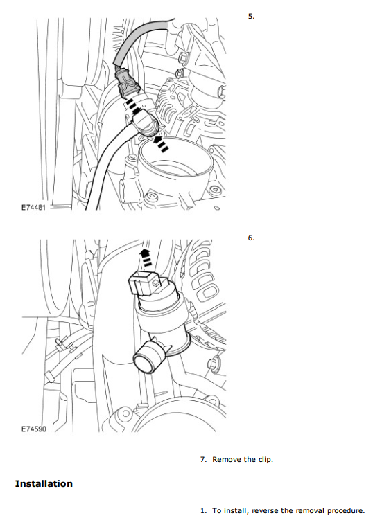

Looking for some help finding the location for the emissions purge valve on a 2008 lr2.
I have spent hours searching google as well as under the car and under the hood.
I just cannot find it.
Can someone please tell me the specific location of the purge valve.
Please be as specific as possible..
I read a post that said it was underneath the car near the alternator.
I removed the under engine panel and got under the car with a light and I still cannot find it.
Any help would be very very very appreciated !!!

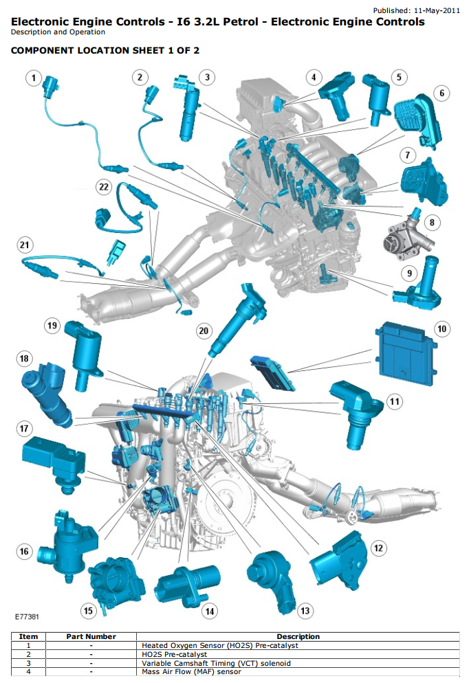

Thank you so much.
Seriously, I cannot tell you how frustrated I was getting. I have bought an online version of the repair manual which contained that first pic but ws still unable to find it.
It did not have that second section with the location details.
My daughter has the car today so I have not had a chance yet to take a look but based on this information I am sure I can find it now.
