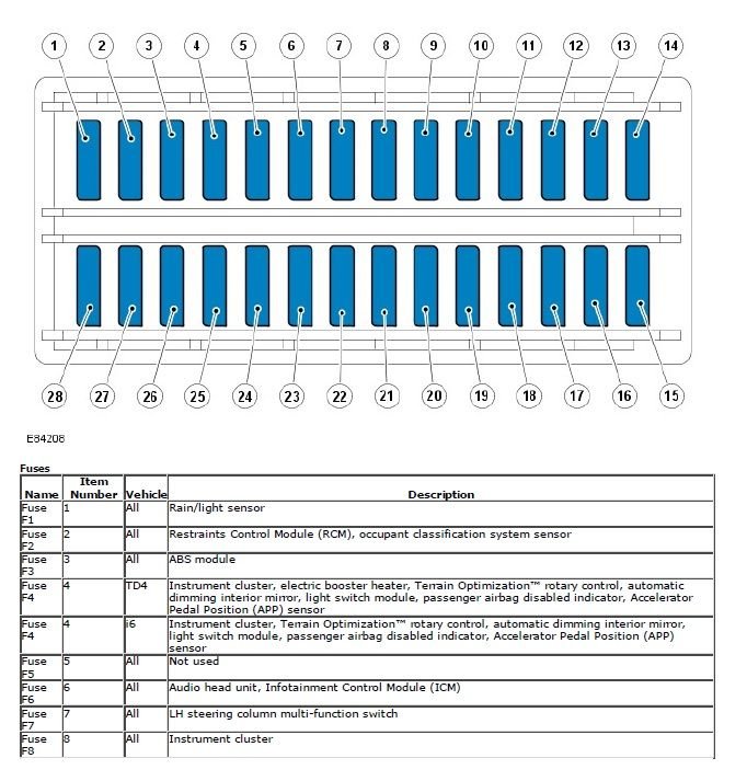

I would look at the electric connections for the fuel system
The fuse that runs the fuel pump module is located in front to the passengers feet
Fuse 22

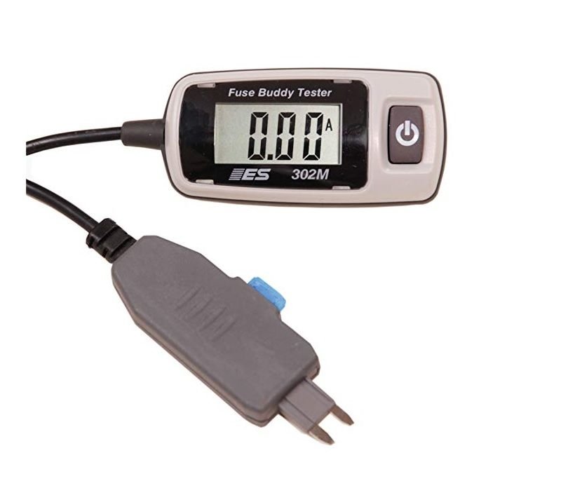

the fuel pump module should draw about 5 amps
For my LR2 I noticed that it won't start until the fuel pump turns on and is drawing about 5 amps
I bought a fuse buddy meter to check it

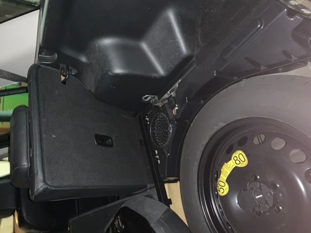

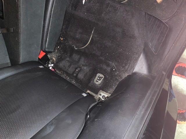

Thanks Paul, so I checked the fuel pump fuse and it is good. I do not have the fuse buddy so I will need to get one of those. However I removed the back seat to access the fuel pump and this is what I found, I would assume this could be affecting the pump or caused it to overwork and burn up? This looks difficult to access, there is framing around it and looks like it requires most of the trunk and back seat removed. Any thoughts?
