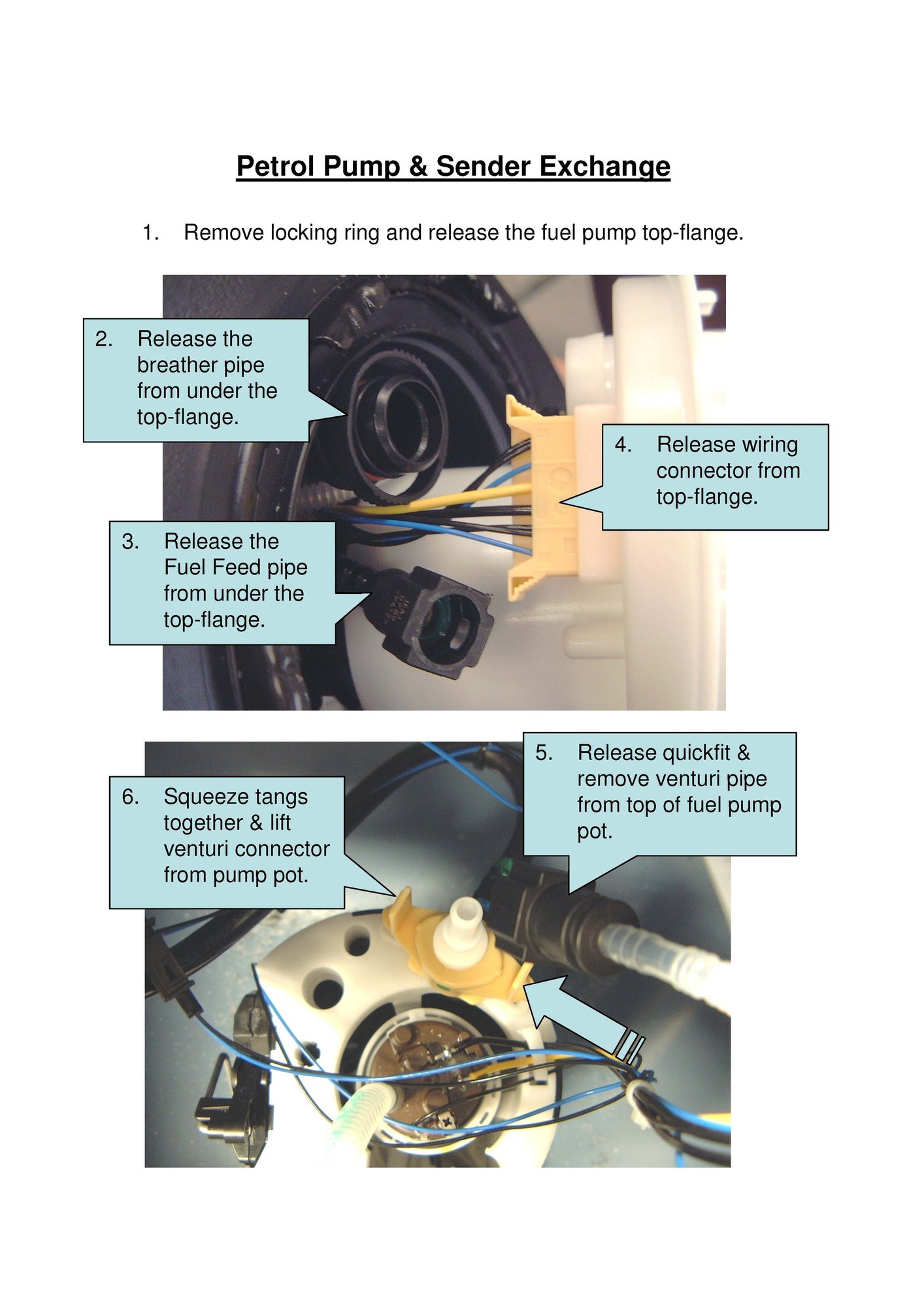

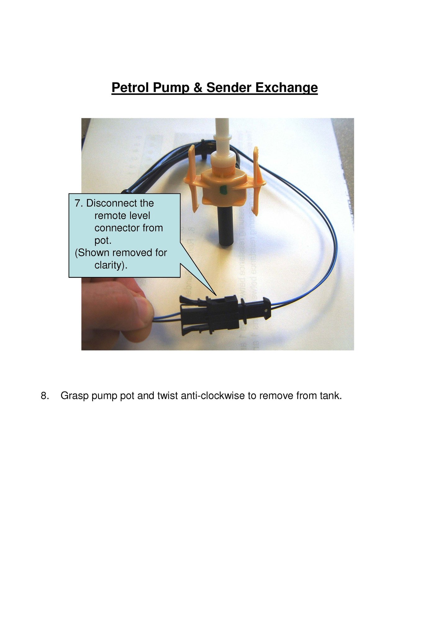

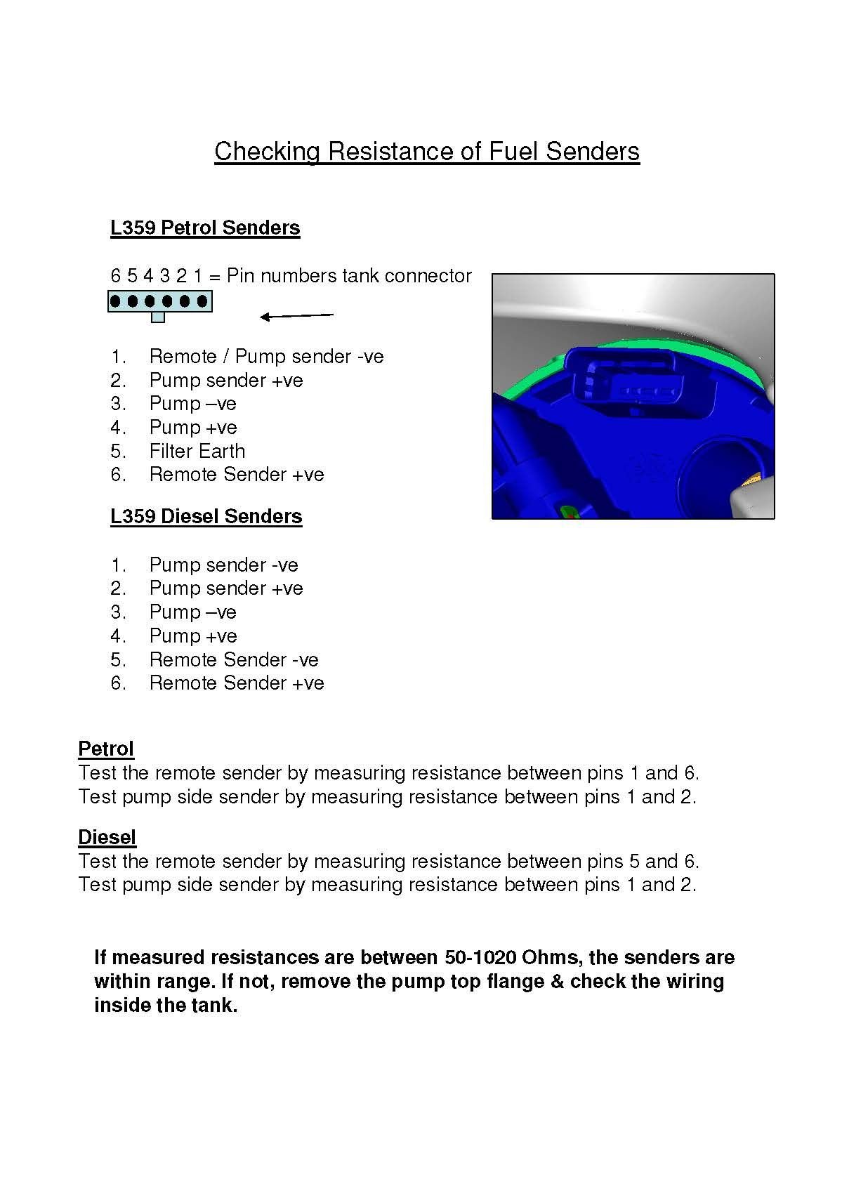

Paul, thanks for sharing all of the info and I believe the fuel pump is not coming on at all. If you can see from my previous picture, the fuel pump is hardly accessible through the back seat and there is a piece of foam surrounding the top of the access to remove the pump. It appears the only way to remove the pump is by removing the bracket and dropping the tank down a bit and remove the foam to access the pump and it will still be difficult, I have never seen one quite this difficult to access. I appreciate the diagram you sent, this is very helpful once I get the pump removed. Do you have any links or forums you can share regarding how to drop this tank or access the pump? Thanks I again for all of your help with this, it is greatly appreciated.
