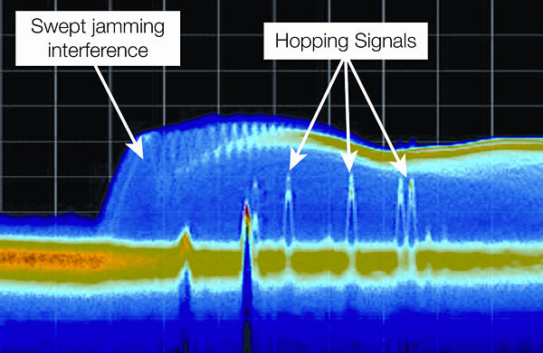

Just bought a preowned 2009 LR2 HSE 4 months a go and Land Rover has already installed a second battery. After sitting for a few days the batteries are completely dead, complete to the point of not accepting the key. My car has currently been sitting at Land Rover for 8 days and they can not get the battery to drain. I have heard stories of RR & RR Sport with the same problem usually caused from interference from radio programmed systems i.e. Home Alarm Systems, neighbor ham radio etc. Anyone have any ideas where I should start looking? Any help appreciated!!

One owner posted about a newer Rover with the electronic smart key. He had the key on a hook by the garage door. The car kept sensing it, and doing what ever the computer does when it thinks the owner is approaching. And killing the battery.
The average metro area is a hive of RF interference, so if it was RF you would think there would be a lot more of it happening.
