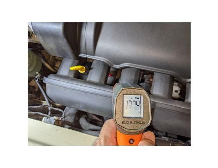

A quick check you can make to give you an indication if the thermostat is open and working, or if it's stuck closed, is to measure the temp of the top/inlet hose that connects the thermostat to the radiator. To offer a benchmark from my LR2, I used my handy IR temp gun to put the red laser dot on the hose where it connects to the thermostat. Just point it through the intake manifold runners as shown in this pic I took.
While my LR2 was idling hot with the A/C on, it measured 177F (80C) on the surface of the hose. This looks reasonable as my cooling system is working normally (knock on wood) and the hose would only get that hot if coolant was flowing through it. If your temp is much lower than this while the engine is idling and hot, that's an indication the thermostat is not opening fully or you may have a faulty water pump.
I don't know how to check the water pump. On most cars there is a cap on the radiator that you can remove (before the engine gets hot) and watch for flow. But the LR2 doesn't have a radiator cap and I doubt you can tell anything from the coolant reservoir. Any suggestions on diagnosing the water pump?
That's a great idea! I have one of those but I only use it for cooking, tells you where my priorities lie.
...I don't know how to check the water pump. On most cars there is a cap on the radiator that you can remove (before the engine gets hot) and watch for flow. But the LR2 doesn't have a radiator cap and I doubt you can tell anything from the coolant reservoir. Any suggestions on diagnosing the water pump?
I checked into this (my OCD wouldn't let me do otherwise). A couple tell-tale symptoms of a faulty water pump are 1) bearing noise that you can hear, and 2) coolant leakage. Do either of these apply to your situation?
