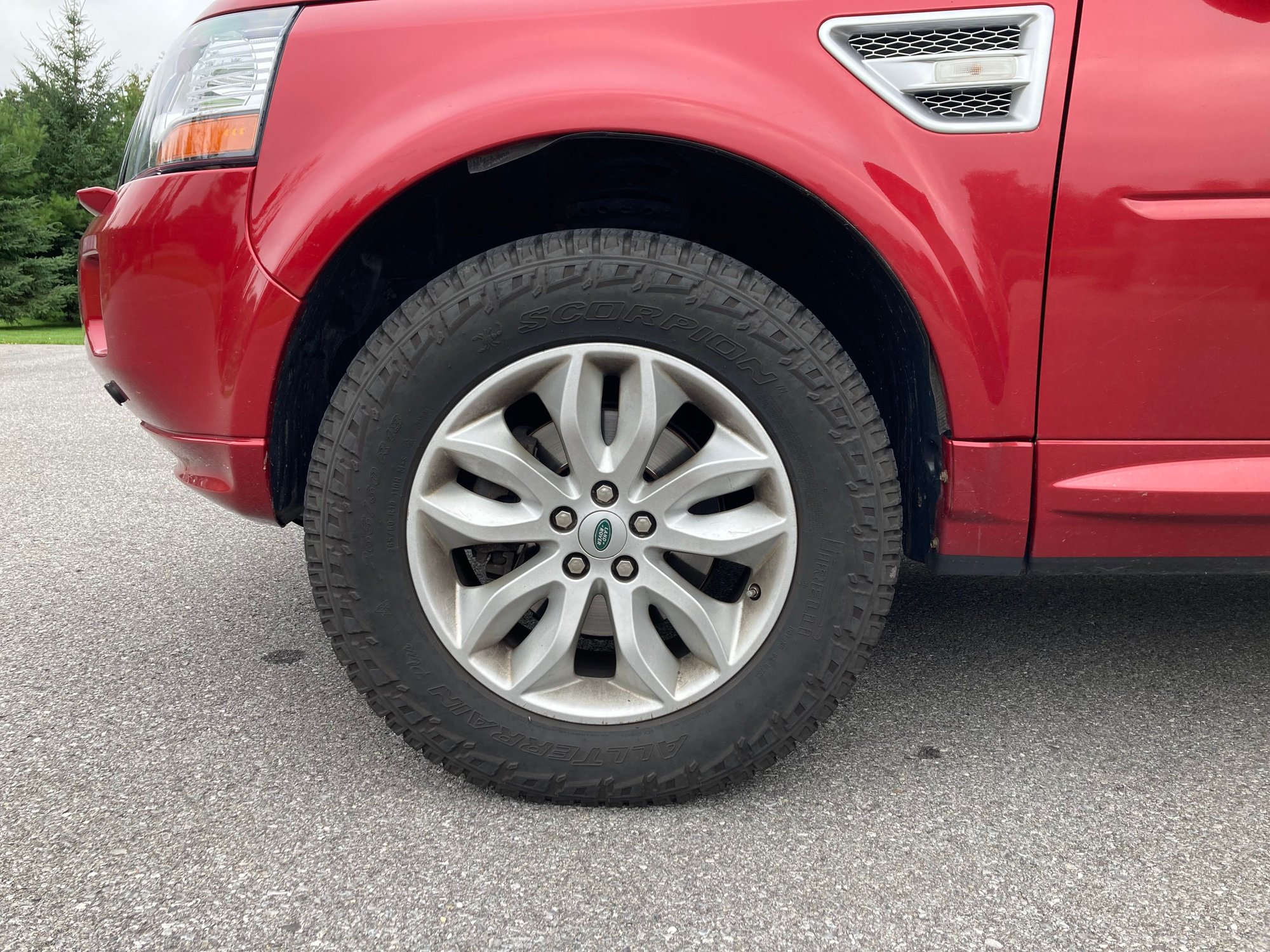

Well... I pulled pin on 265/60R18 Pirelli Scorpion All Terrain Plus.
They fit. Barely. But no rubbing.

I have to replace my second set of Cooper Zeno LTZ tiers. I found out they no longer make them, so I’m looking for an alternative. One of the ones I’m looking at is the Pirelli Scorpion all terrain plus tires. Guy, how are these tires on your LR2? How is the tire noise on pavement, and have driven them in the snow? I’m also considering the Goodyear Wrangler Duratrac and the Toyo Open Season AT III.
let me know what your experience with the Scorpions.
Old Sep 6, 2022 | 08:27 AM
  #60
guy's Avatar
guy
Joined: Apr 2019
Posts: 965
Likes: 218
From: Ottawa, Canada
Yes, noisy on the pavement... but no more noisy then my winter tires.
Truly, they grip like crazy. Whether in the rain on pavement, mud or rock. And equally good in the dry.
I drive the LR about 75/25, pavement/gravel, off road split. So I've learned to turn up the stereo on the highway.
I did drop the air pressures by about 3 lbs. from the recommended pressures. I found it a little too bouncy.
