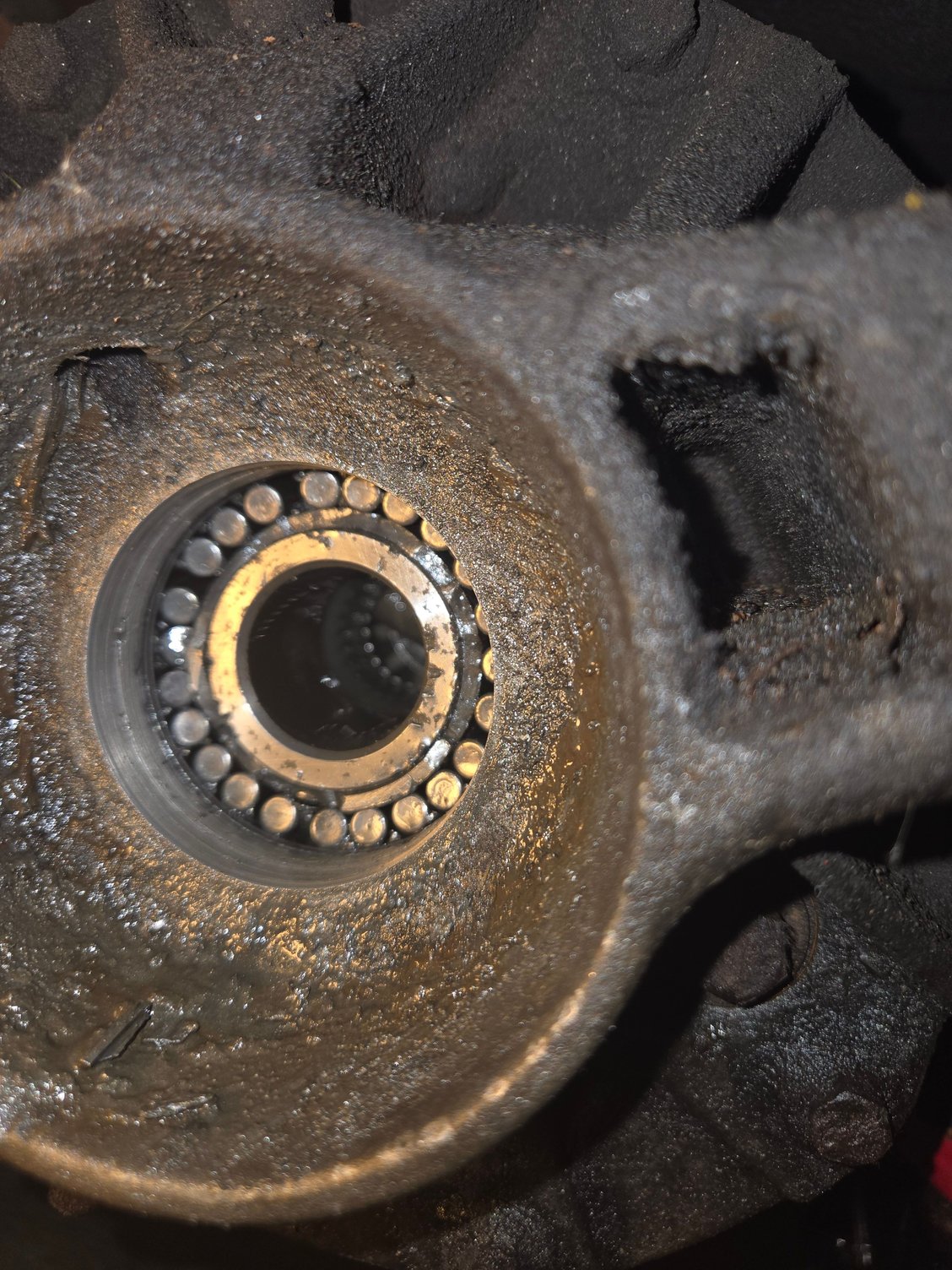

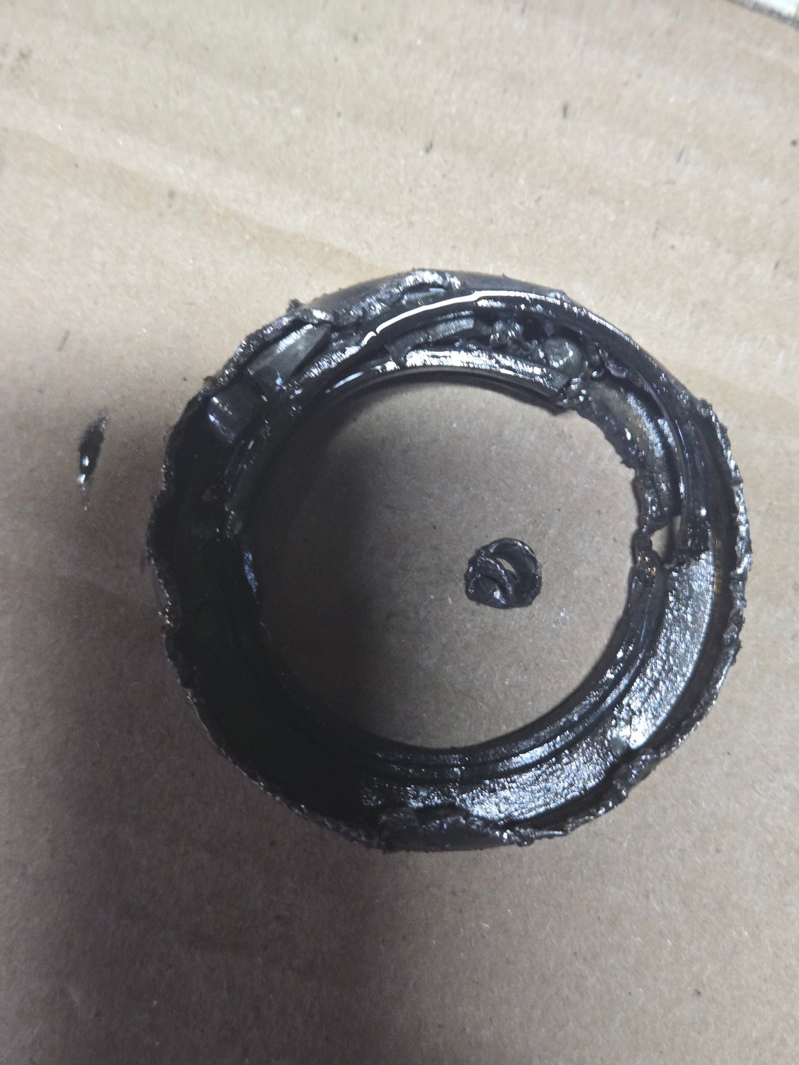

Hi, I got an rear axle seal leak. When I opened it up I noticed my axle seal torn apart and the bearing is done. I'm just trying to find Which bearing is it from rockauto to replace.
They have a selection for pinion bearing or is it Carrier bearing.... 2008 Land Rover LR2 SE
Rear differential axle side.
Thanks
This is what mine looks like.

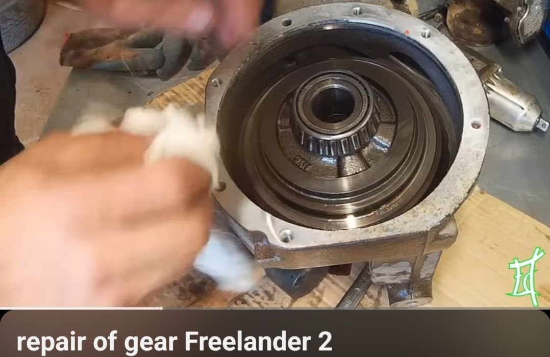

This is what it should like from YouTube

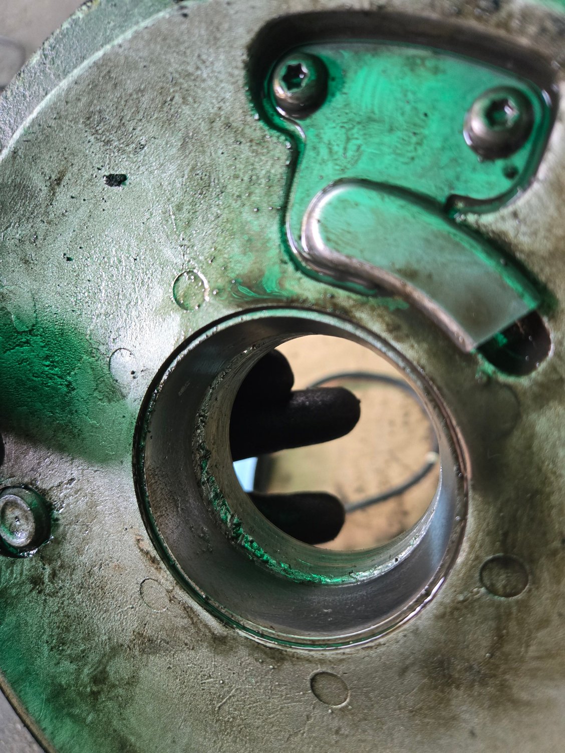

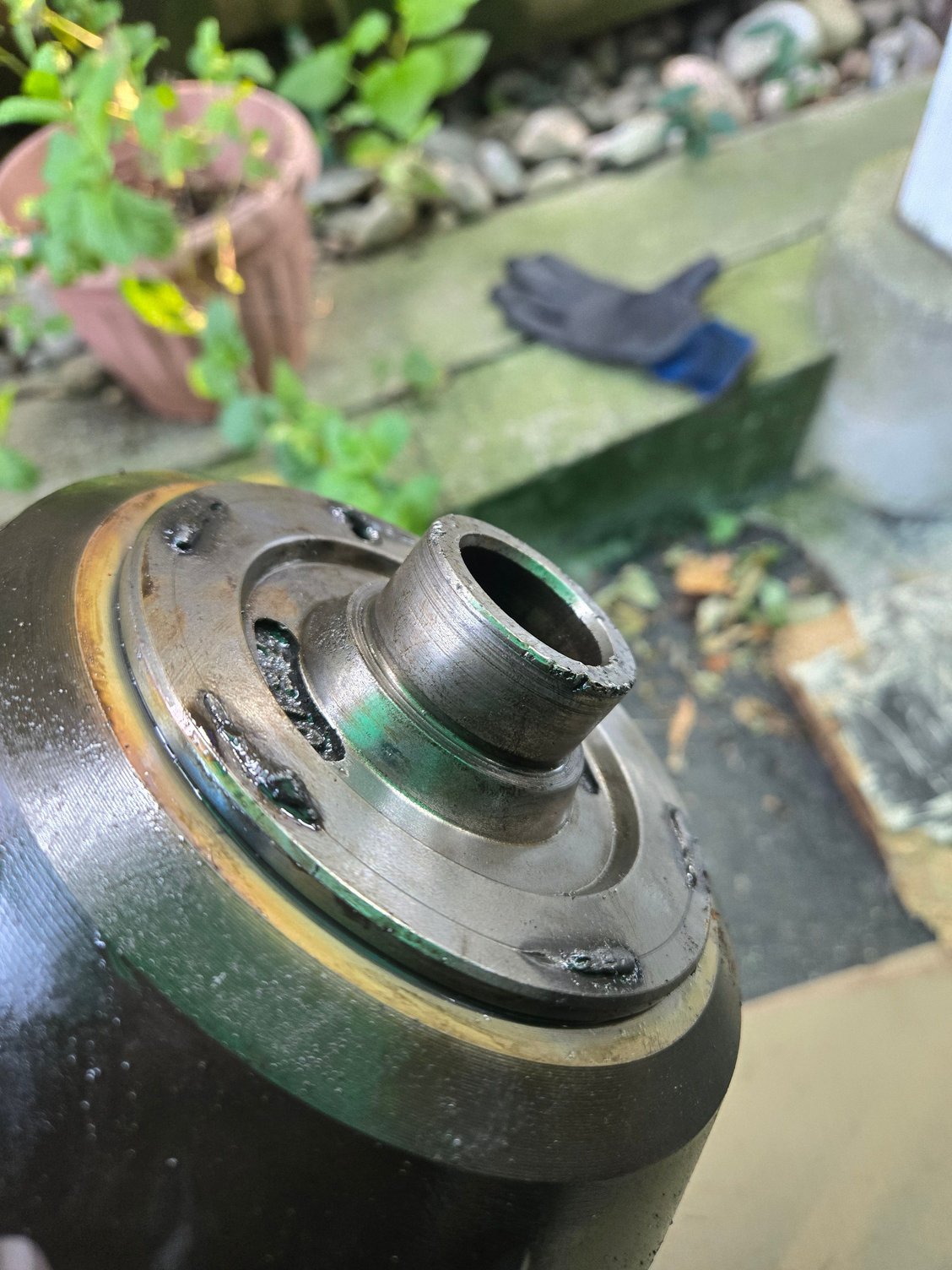

I took off the rear diff barrier case today and the bearing came right off. I was able to order the new bearing from Rock auto. My other issue is that the diff cover inside where the axle seal sit is worn out. I can't seem to find the diff cover anywhere.
