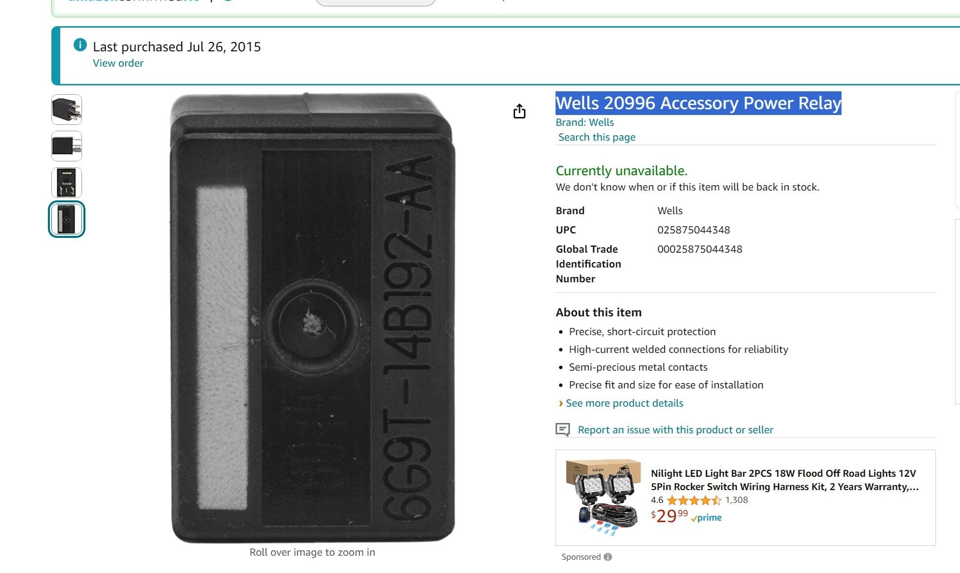

I replaced my original relay in 2015 (preventative maintenance)

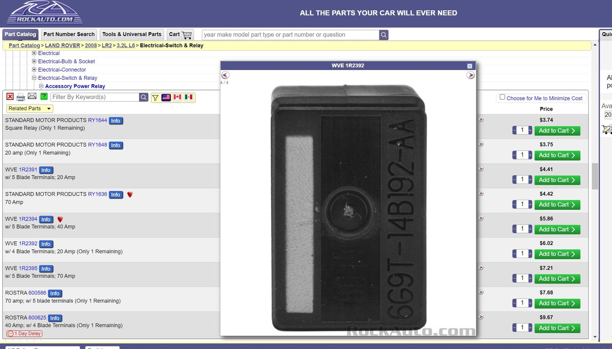

Here is what I bought
But I can't find anyone selling that exact part
So here is what I would get instead
WVE 1R2392 Info
w/ 4 Blade Terminals; 20 Amp (Only 1 Remaining)
It appears that WELLS became WELLS VEHICLE ELECTRONIS
So now its WVE 1R2392
Here is the Land Rover part number OEM / Interchange Numbers: LR003748,

Land Rover is not helpful
Rock auto search for WVE 1R2392 then click on INFO
The page that it brings up shows the OEM interchange
