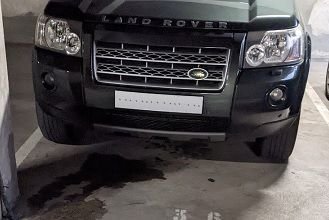

Hi,
I need to replace the coolant radiator of my 2009 Freelander 2 2.2 TD4 SE (Auto).
id you you know where I can find a tutorial to help me to do this ? Is their a solution without removing the airconditionner radiator ?
Thanks for your help.
