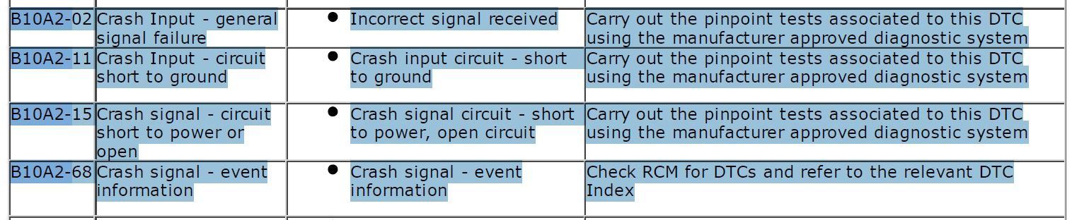

B10A2 (Crash Input)
This. It needs to be reset.

And this is why you don't use garden-variety readers on these cars. There are four variants of B10A2.

Yes, flybd5, My Autel Scanner could not erase the B10A2....
So, besides the factory scanners, and the Snapon Verus, are there any others who could erase this code?
