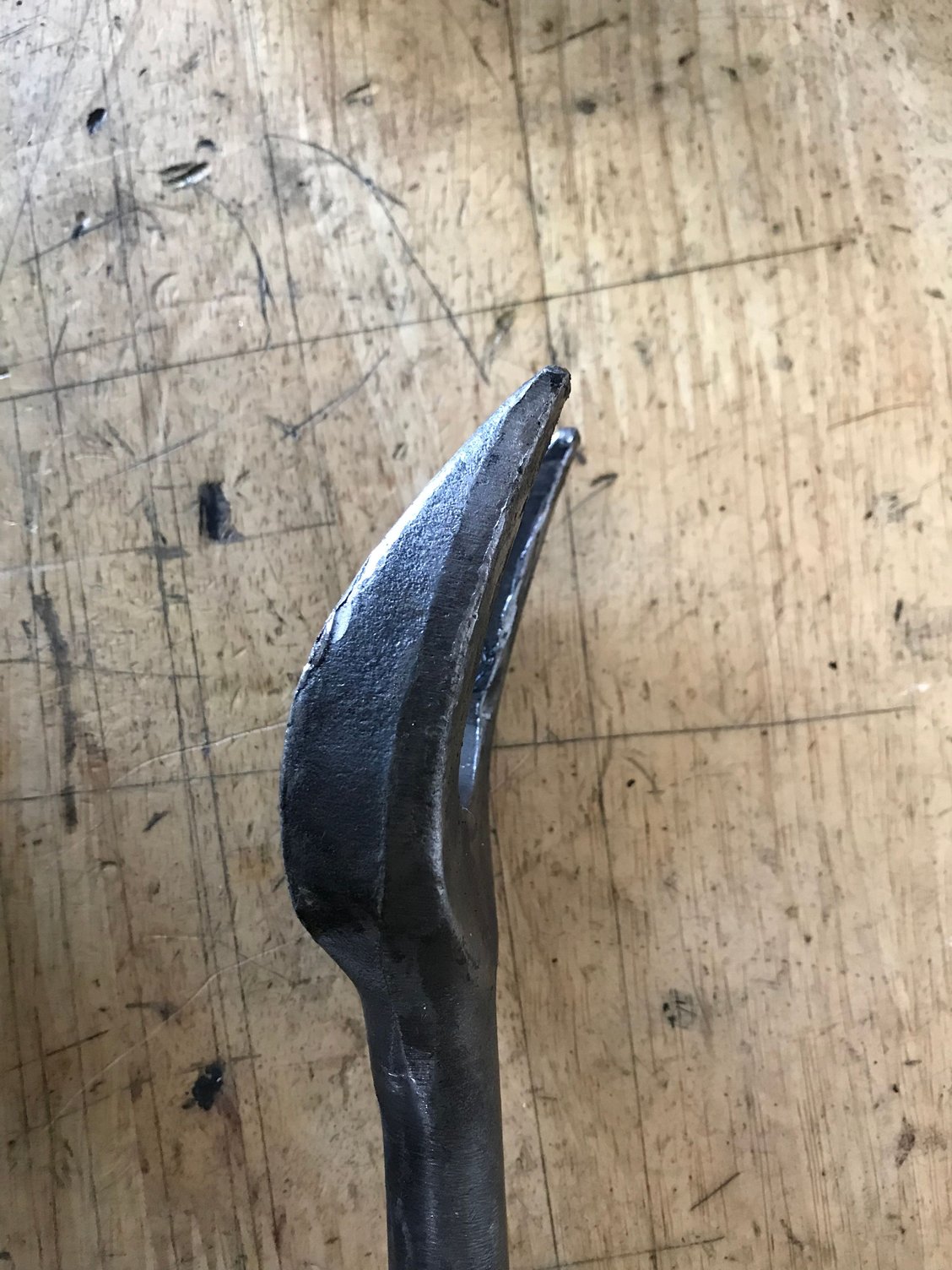

This s the tool I use. Get the claws against the can portion and use as a rocker pry bar.
