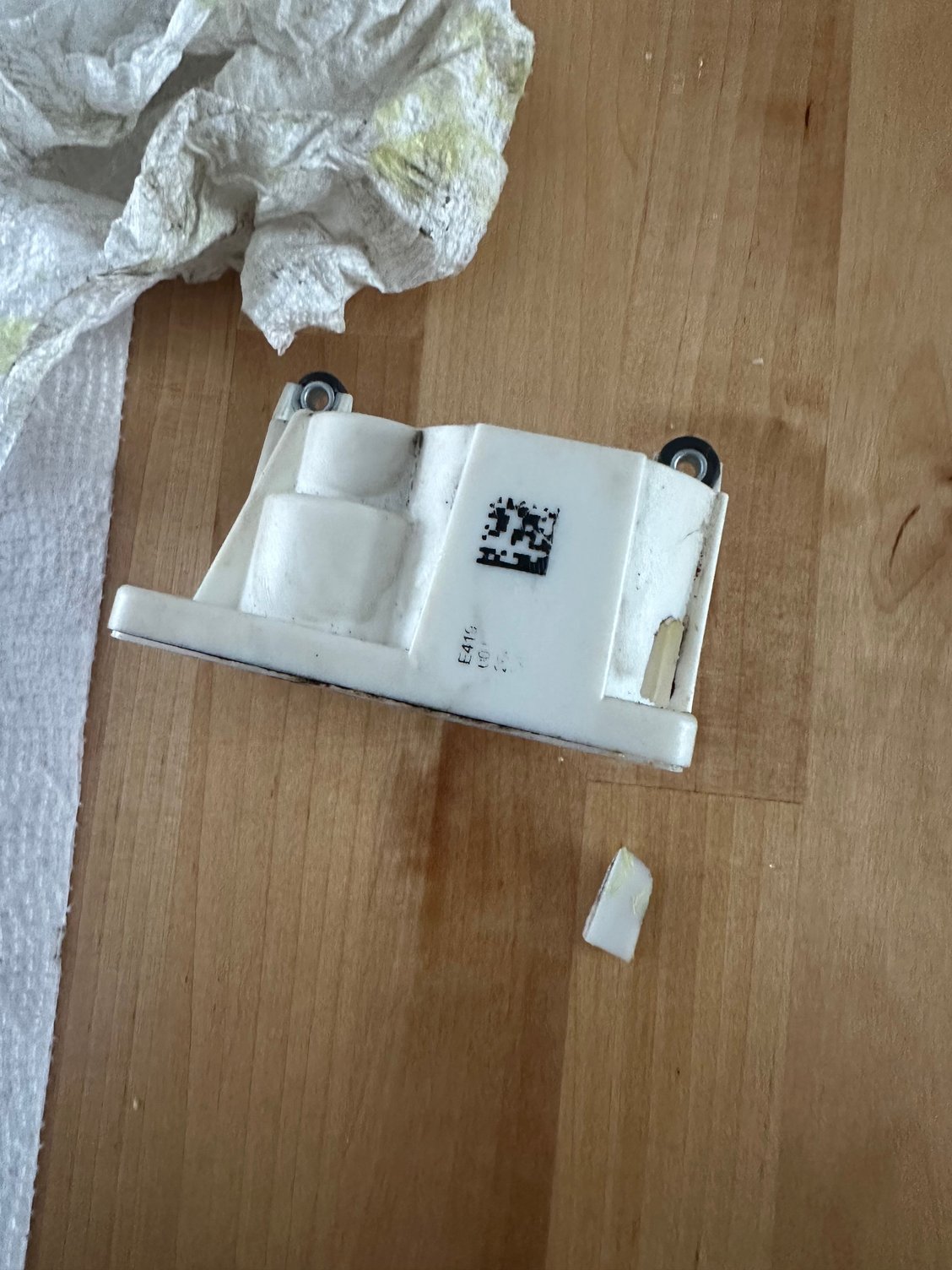

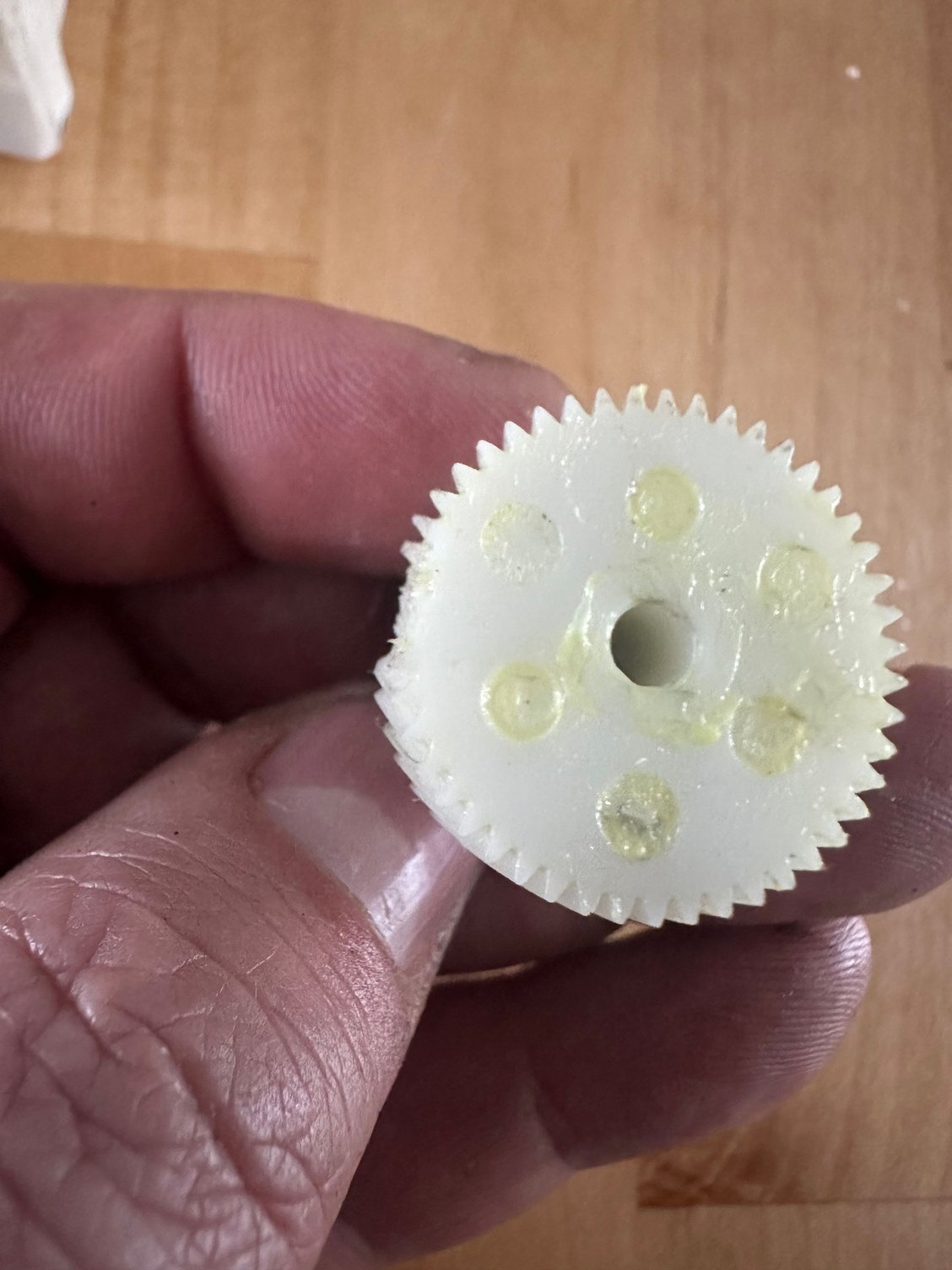

After trying to adjust and fiddle with everything, I realized that the e brake cable on the driver side was threaded into the spline that the motor turns pretty far. It was so far in, that the mechanism would jam up against the square end of the brake cable. So, I unthreaded the cable a ways until it was in approximately 5 turns. I then readjust the brake shoes and tires to run the parking brake. This time, the parking brake set the way it should. When I went to release the EPB, I got a very high pitch whirrrr sound. At this point I knew the gears were damaged. So, I took the actuator out and found one gear had the teeth ground off of it and there was a small hole in the housing. The housing has very high tolerances around the gears. I think that there was so much torque when the EPB was trying to set that it flexed the gears enough that that the big gear caught the edge of the housing and ripped a chunk of the housing off.
ordering a new gear set and and trying to see if I can find a housing off of a junk EPB.
