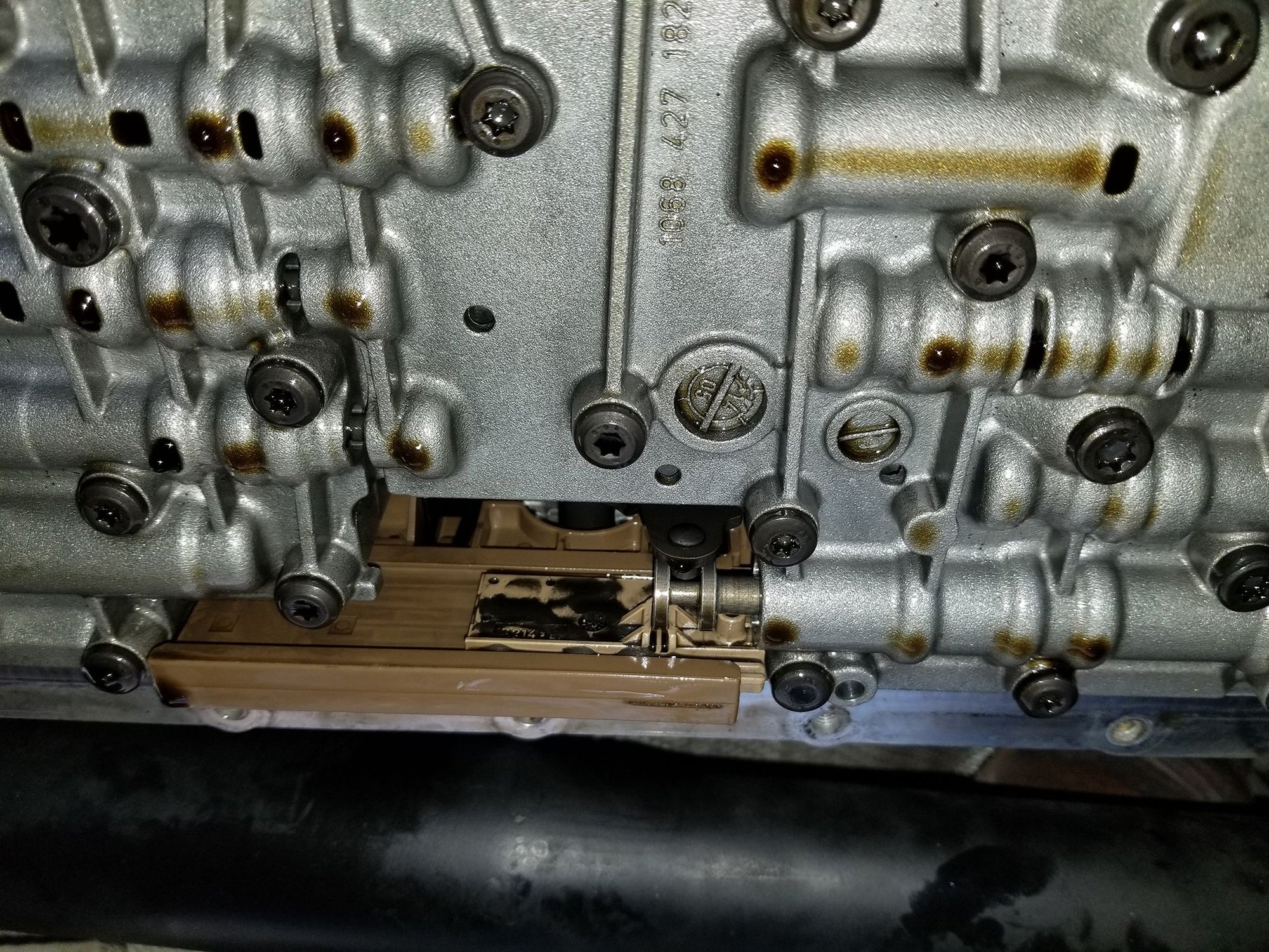

So the cable adjustment is easy. It is possible the traveling mechanic did it wrong, but I still don’t understand why it needed adjustment in the first place if the slider was aligned correctly. The nub on the slider in the TCM needs to line up with the mechanical plunger that controls the gear selection. Then, when you install the valve body you need to make sure that the nub on the shifter fits in the other side of the plunger. If you are not positive that you did both of those things so that they look like the photo I put up then I would take the pan off again and look as it’s probably possible for it to get damaged if it is not.
The fact that it rolls in park is unrelated to the alignment of the shifter sensor and plunger. It is purely controlled by the cable adjustment, so if it’s rolling in park, and you’re sure the shifter inside the car is in park, then the cable adjustment is not correct or something is broken.

I'm gonna drain the transmission tonight once I get home and take the pan off and look at the plunger to make sure it's in the correct location, I'm starting to think thats the whole issue, hopefully I won't find any damage done. I'll take pics and post them tonight or tomorrow. Thanks for all your help and knowledge.

Heres my pic, wrong position

Glad you found it. Hopefully no actual damage has occurred to the slider. Don't forget that you are going to need to re-adjust the shifter cable once you get it back together.
