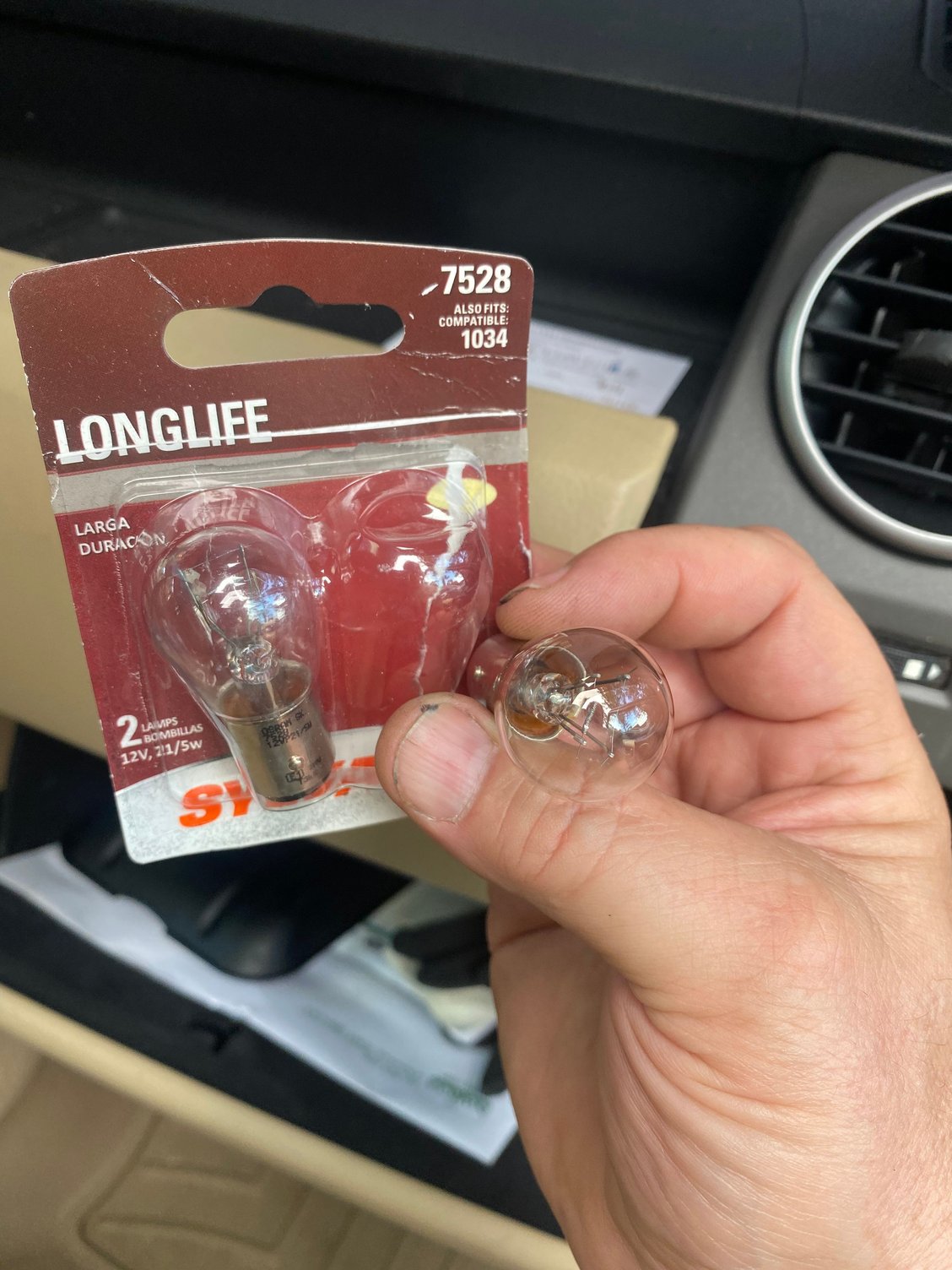

The likely culprit is the brake light switch. Part number options are here:
https://landroverforums.com/forum/lr...n-fault-99009/
Also confirm that the proper tail light bulbs are installed. The filaments need to run vertically when in the sockets.
