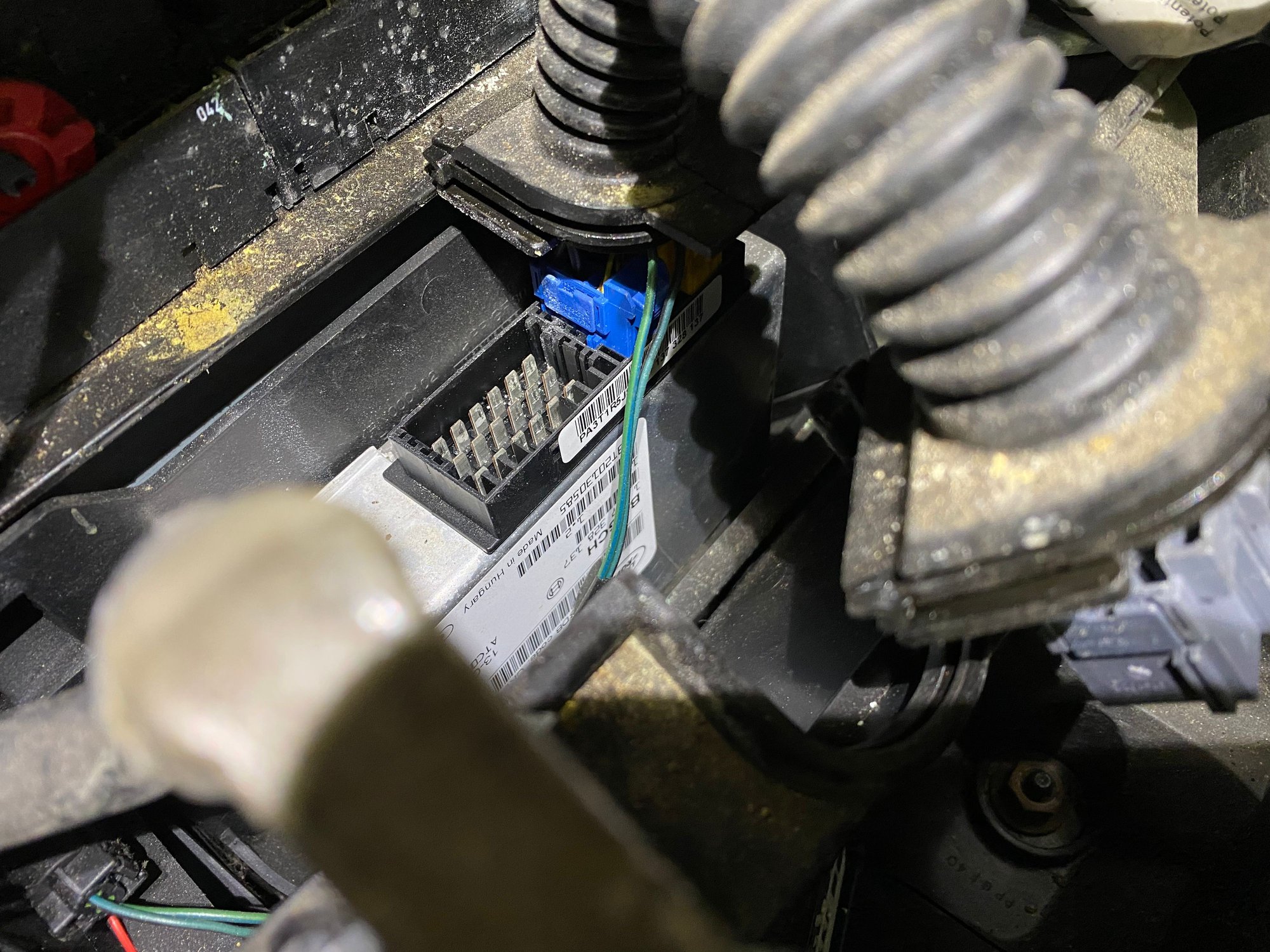

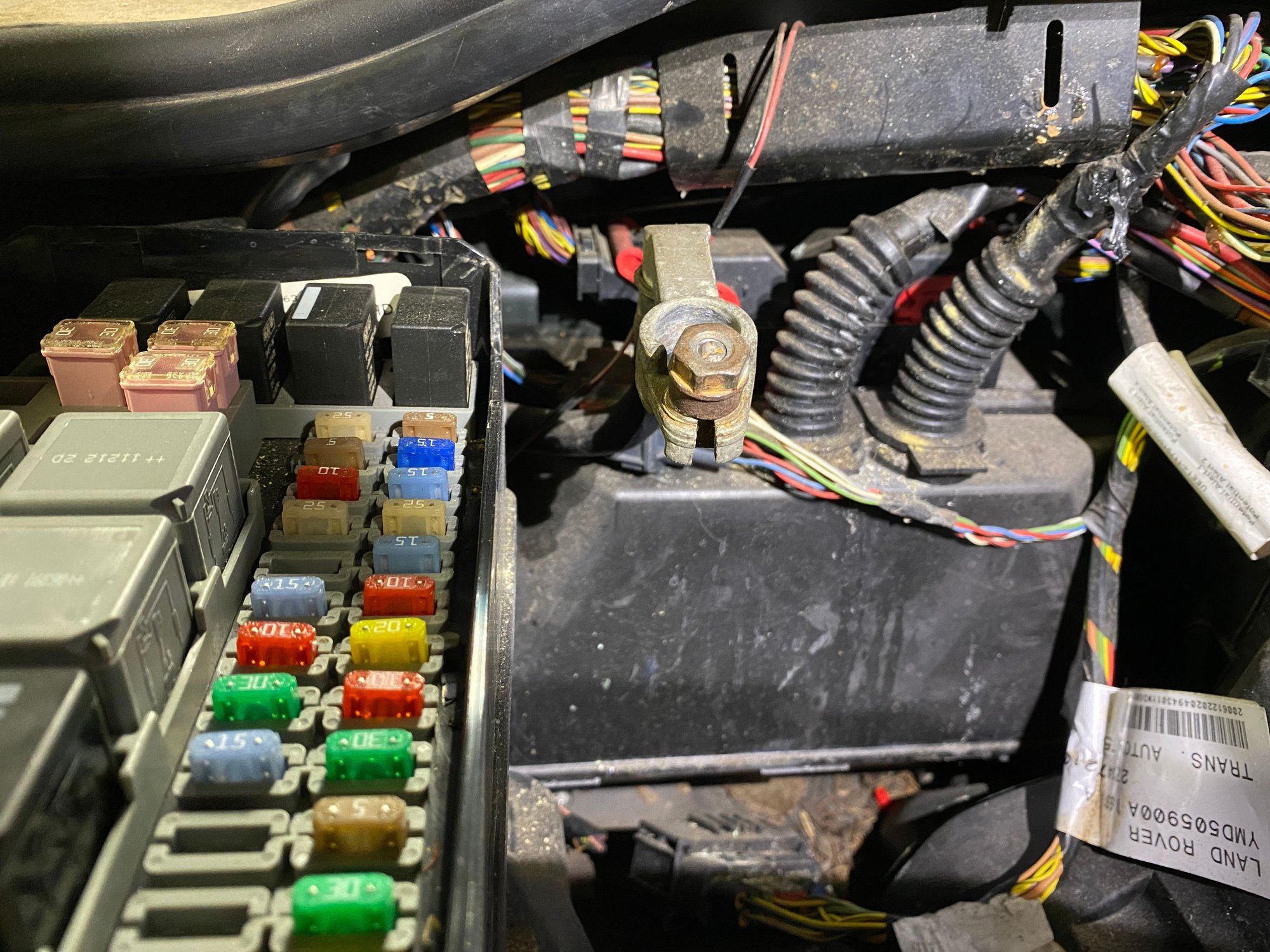

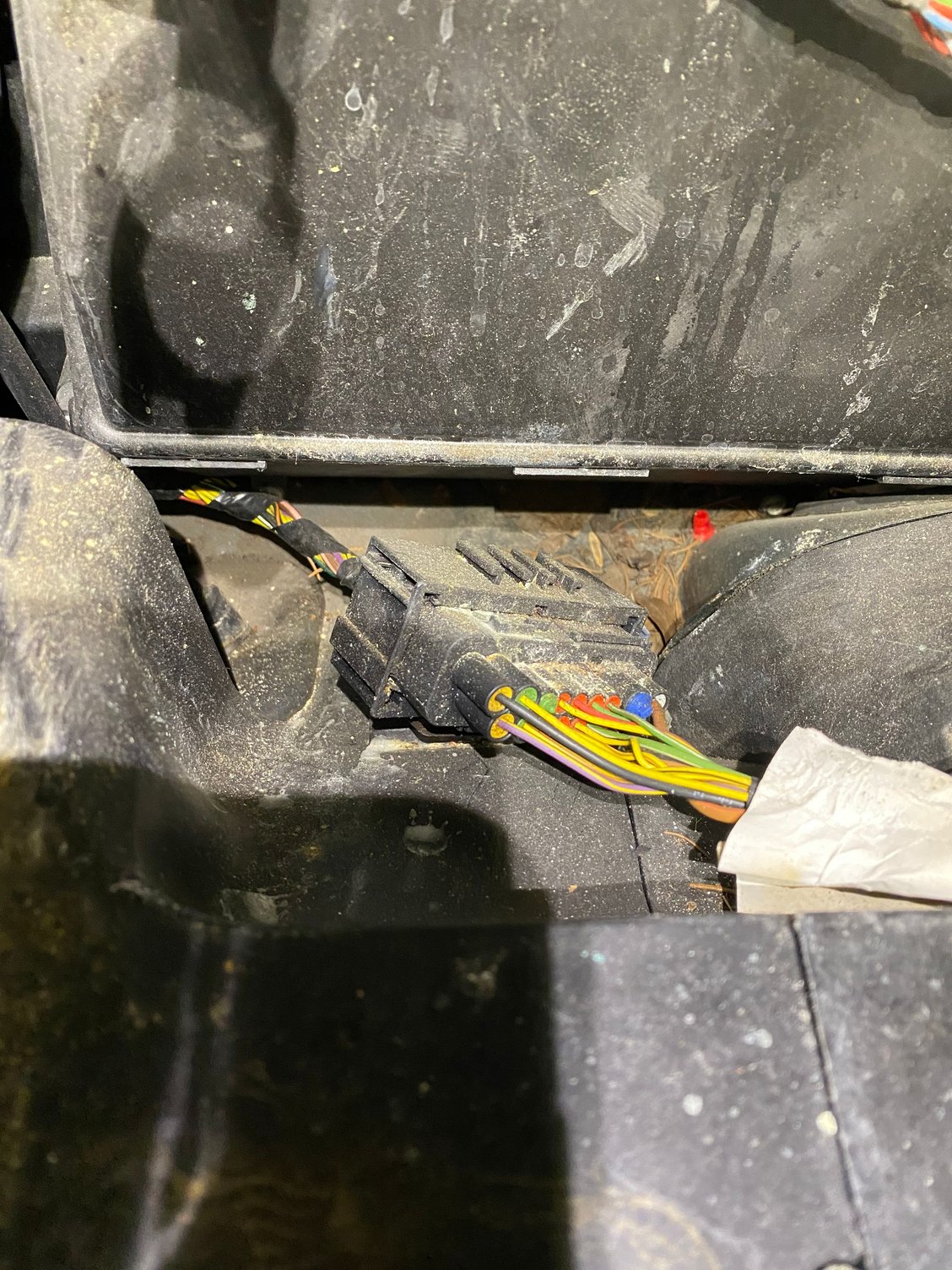

Old Jul 9, 2023 | 09:50 PM
P-Bod's Avatar
Joined: Feb 2022
Posts: 415
Likes: 177
From: Highland Village, TX
There are vulnerable connections behind the battery that do need to be inspected. I took these pics when I first started digging into mine. It’s not terribly difficult to check once you pull the battery.

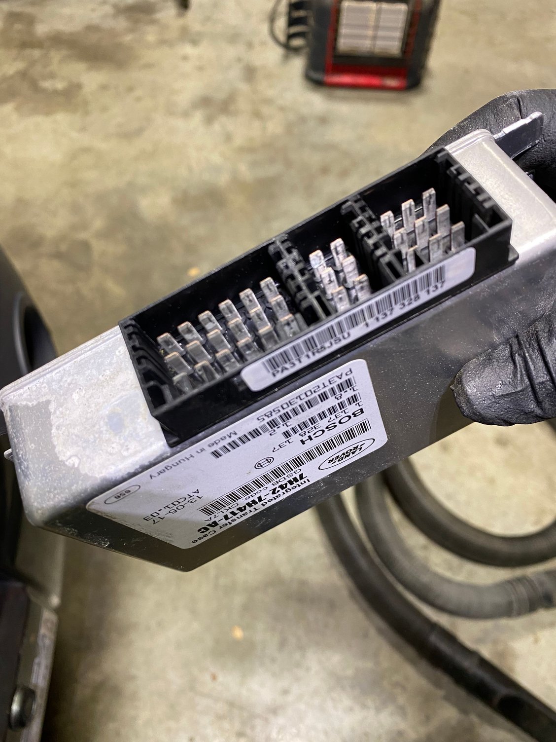

Old Jul 15, 2023 | 11:00 AM
4bear4's Avatar
Joined: Aug 2021
Posts: 28
Hi
Quick update
So I puller all the wiring including the silver box from behind the battery. disconnected , cleaned and replaced.
Checked all the fuses in the engine fuse box
Car started but immediately shut off when I applied the brake,
Now sometimes starts, sometimes nothing at all
Other times wipers/hazards etc.
Scan tool continues to state that car has lost communication.
Will look to tackle the towing harness next!
